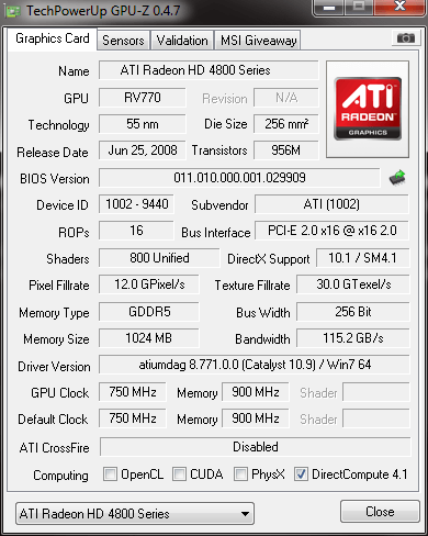

Im starting to get what looks like graphical errors across the screen. Horizontal lines. Just recently O/C to 3.4ghz. Im running a i7 920 and 4870 in win 7 64bit.
Any ideas?
Cheers

I hope its not the card. Though Ive had problems with it before. Kind of Ironic, I thought Id pop on an O/C and before I even did anything, Ive had this problem.

What exactly am i doing on this Furmark? I ran a stress test until it got to 75c. Then I chickened out. It was only going for 1 Minute
That is interesting with L4D. Again the graphics card is the main suspect - as the CPU will not be heavily tested. However, to completely eliminate the CPU - have you run Prime95 and Intel Burn Test to the point that you are satisfied that it is stable?
With furmark I suggest let it run and see at what temp it tops out at. 75c is pretty safe for that GPU, I suggest stopping the test only if it goes much over 90c.
I found the source of the problem. And I should have known all along as Ive had a similar problem before. After taking the GPU heatsink off, most of the thermal paste had worn out. It wasnt that long ago that I replaced it (I know how to do it properly). Ive been using Akasa Thermal paste and I think its time I buy a decent brand. Same problem, twice. Not good.
