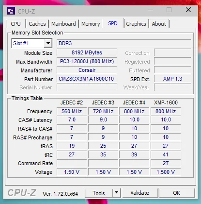

You usually go into the motherboards bios, look around the memory section, look for the XMP option and choose the profile (there is data on the RAM that the board reads to set the speed/timings/voltage up to the rated RAM specs) then save+exit.
If unsure you can download CPU-Z and post up a picture of the SPD+memory tab.
CPU-Z SPD + Memory tabs..
