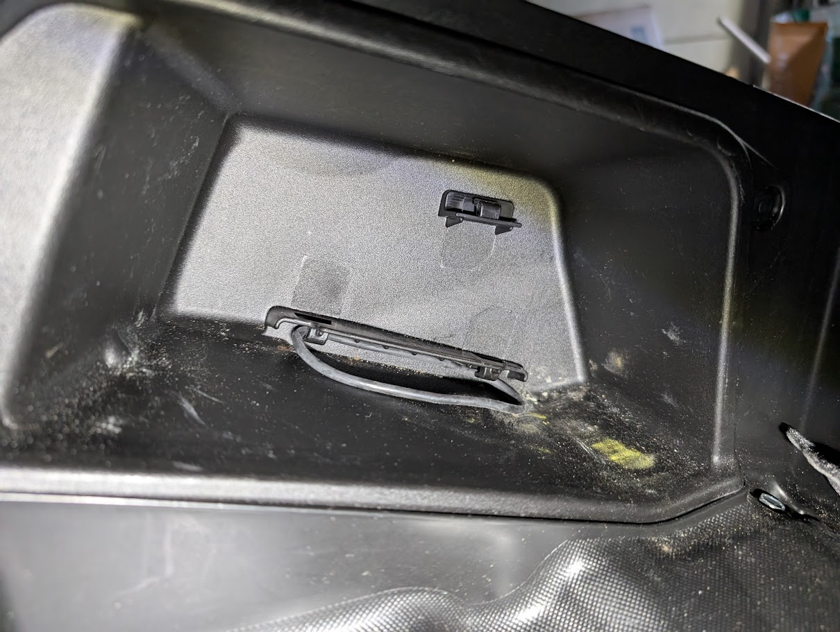

This is a little cubby on the side of the under-seat storage on my scooter. The little hooks are for a rubber band which holds the standard Honda tool roll in place (it's a bit dirty in this pic, it's been cleaned since):
The hooks are molded in place so can't be removed. The space is incredibly underused and very poorly packaged. I'd like to print my own little box that can slot in and contain some tools / air canister / small torch / etc. I've managed to do a 3D scan of it using the app, but as you can imagine it's extremely rough and only to be used as a guide, but it's a starting point. Ideally I'd like to be able to pay a pro to hop on a Teams / Zoom / whatever call and teach me as this will be the first of many little projects. It's quite frustrating having the vision but not the ability to do these things myself, and looking around online, there are a million different ways of doing it, and loads of them involve using addons that are no longer available, or software that's no longer supported / etc.

Having the scan is a great way to start, if I was drawing something to slot into there I would normally start with the customer model of what they have and then draw my parts to suit, finishing with an assembly of all parts in place to kind of proof fit before actually machining anything.

Unless I am missing something, could you not take some straight measurements and using some radius gauges sketch out the bottom of the tray then extrude the to the height with a outward taper and then finally sketch two rectangles on the bottom face and create pockets to allow those existing parts to fall in too? Could also then add a fillet to the bottom for the curve on the perimeter.
Super rough 5min job to show what I mean, obviously no real measurements just a rough sketch. I would then import that in to a slicer and cut the top and bottom profile leaving just a few mm to print and then test the fit.
