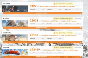

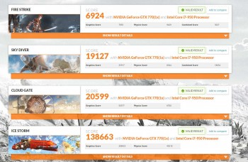

Here are the 3d mark tests for each.
Certainly a marked improvement! Nor sure why its complaining about the driver as only just downloaded it.
