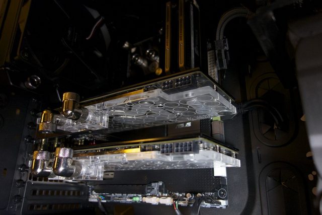

Not sure which dimension you wanted measuring so I measured a bunch.
I assumed you meant FC Bridge as that is what GK110 blocks use.

It's 25mm unfortunately :(
