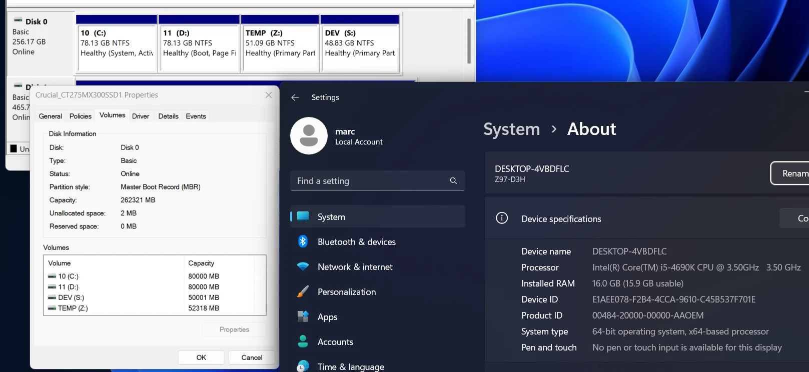

Where do you have confirmation that 24H2 works with a 610e? From what I can see, it lacks the required instructions and I'm not sure if RUFUS works with 24H2 yet?
TPM/secure boot is the twaddle I was talking about in my original post. Windows 11 certainly does not require this.
I'm running it on a MBR drive and no TPM...
My haswell cpu is not officially supported but it does have the required CPU instructions and therefore it works.
