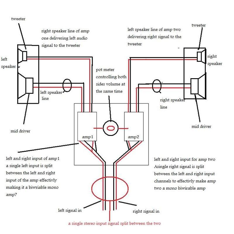

I have in the pipeline plans to build a DIY amp and have located the ktis i want to use. the amps are rated at 25watt over 4 ohms and ive been told that with efficient speakers ill achive 90db so pretty loud.
when i build it for a short time it will be used to run some 100w max music power 4-8ohm biwirable speakers. this is were my idea comes i just dont know weather it will be atall possible so ill try to explain and have drawn a diagram to try and better explain my self.
mind the l33t paint skillz
the amps like i say are 25w stereo amps, my plan or thought is to wire each so than deliver only a left or right signal over two channels to feed into the mid and tweeter seperatly, in effect making each amp a mono biwirable amp then using the two to build a single 2 board amp. is this possible and will i gane anything from it ie better performance form the amp, the extra cost of this over using a single amp to govern both channels is £30 so not a massive cost.
