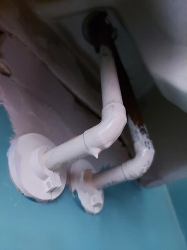

I want to replace my bathroom sink and tap with something new but discovered that the pipes leading into the existing taps come straight out of the wall and into the tap. My new tap has the flexible hose that screw onto the pipe. What do I need to be able to install the new tap to these pipes?
Assuming your current hoses are threaded at both ends, then change them for some that have push fit at the other end. Then just a case of cutting the copper pipe and then slipping them over the ends
Does your new taps come with compression fittings on the end? a nut and olive to go over the copper pipe?
Doesn't look like there are any isolation valves on your pipes either so you will most likely need to isolate your hot and cold at the source unless you can see some isolators elsewhere for this sink.
You will want to clear all that paint off as well.
The fun of new built houses. We did the blue but for some reason they slapped paint all over the pipes.

They are but one end goes onto the tap and is smaller. https://www.wickes.co.uk/Wickes-Yaran-Chrome-Basin-Mixer-Tap/p/161697#
This is the one I purchased https://www.wickes.co.uk/Wickes-Yaran-Chrome-Basin-Mixer-Tap/p/161697#
Came with hoses that screw onto a pipe.

It didn't have compression fittings with it but after reading it seems that all I need to do is fit a compression fitting to each pipe, add isolation valve and screw the flexible pipes that came with the tap into each one.
You could actually just use two of these if you want isolation valves, the hoses from the taps should screw straight on.

Though it may work, I wouldn't want to rely on the sealing washer making good contact to a compression fitting.
Id do as above suggested change the Flexi pipes for a push on type with valve built in.
If you don't want a valve, something like this.
