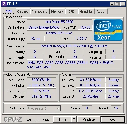

Bit odd in that it should show the actual model number under the name field (or at least does on the V1 E5 i've just tested) rather than just Xeon E5 V3
e.g.
It is a stepping 1 CPU, but the version of CPU-ID is I think the latest one. Not sure if it's just not being detected properly.
