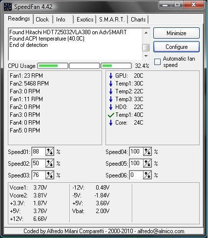

Fan wise im running a 12cm in slatted slides 12cm exhaust and the 12cm PSU fan. Arctic freezer rev2 and the GELID Icy vision all the fans are at the minimum speeds and its nigh on silent What coolers are you using? and as asked previous what case cooling
Speedfan shot below for you i know the fan speeds are odd i dont think the sensors like very low RPM's an the 40c im still trying to find!
