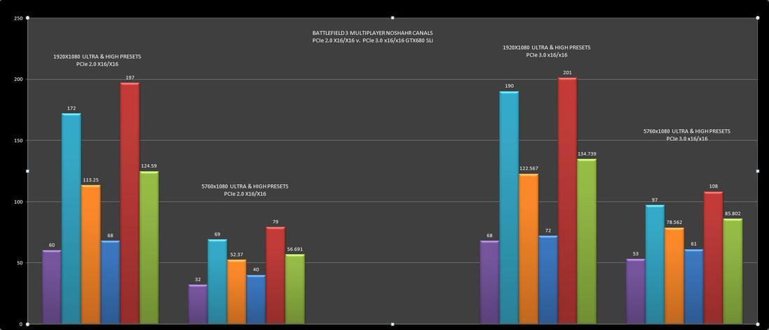

After looking at the graphs below, can you please show me where it is so clear to you that you clearly won't have a huge bottleneck?
I would really like any sources that bench SLI 680/7970 with multi monitor setups such as the ones listed below.
This is 'huge'. If you want more information, talk to Vega, these are his results.
The bars you will want to be looking at are the 2nd and 4th set, as they are the multi monitor setups.
This is also 'huge'. If you want to contact the person who made the graph, ask me and I'll find out where I got the graph.
Are you not reading the graphics correctly?
32>53, 62% increase
69>97, 41% increase
52>78, 50% increase
40>61, 51% increase
79>108, 36% increase
56>85, 52% increase

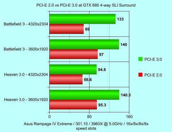

'Unless you plan on getting 4 cards'... I assume this is a mistake because you did not read the 2nd graph correctly. If you did, you should mean 'Unless you plan on getting 2 cards'. Plus, I have a single 2560*1440 screen and I'm expanding on this soon.
Holy **** you must not be able to read
> PCI 3 is incredibly important for multi monitor multi GPU setups. I have a U2711 which I'm expanding, when I do, I will need to go from a single 680 to 680 SLI. When this happens, PCI 2 would be a huge bottleneck.
and then you respond
> unless you plan on getting 4 (you should mean 2) cards or some crazy high res monitors, then i cant say claiming the bottleneck is gunna be HUGE is an accurate statement.
When did you read I was NOT getting a multi monitor setup and that I was NOT getting 680 SLI?
4 way SLI? Not exactly a representative benchmark.
The second graph is better and yes, it's still not huge. No-one disputing there's probably a bottleneck but come on - rein in the rhetoric.
I will also admit the 2nd graph is more represntative of what I will be experiencing, but:
32>53, 62% increase
69>97, 41% increase
52>78, 50% increase
40>61, 51% increase
56>85, 52% increase
How is that not huge?

Key to this is the source, without that the graphs are worthless. This is one case where a decent scientific method is required.
1st one, ask Vega about his methodoly.
2nd one, go here to found out, the board used for that bench was the Asus P8 Z77 WS
