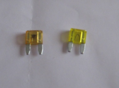

Sorted it dodgy fuse chargers working now :)
one on the left partialy blown ? wierd it was getting some power
Not seen that before, but if the fuse has gone high resistance without blowing then that obviously explains your issue. Nice and easy fix luckily.
