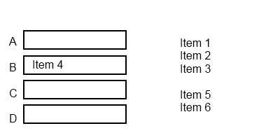

I've seen an example of this somewhere on the web but can't find it again. I want a list of items that I can drag to another empty list. For example:
Then be able to commit the left list to a database. I'm pretty certain the example I saw was using jquery.

This is close but I would like to be able to remove them but also the place where they are dragged to needs to have defined sections (see A B C D in my example picture) and the user needs to be able to select C for example without needing to populate A and B first.

It is CLOSE but fundamentally not what I want. I want a list of PLACE HOLDERS where items can be dragged to. See my example in the first post.

This isn't what i'm after. See how when you move an item from one column to the other, the column makes room for it and the other items move. I want to be able to drop an item ON TOP of an area. For example:
You have a list of people.
You have a list of appointment times.
You want to drop a person ON TO an appointment time.
Get it? Im obviously not explaining this very well! lol
