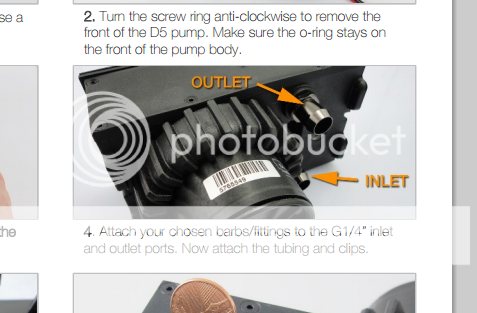

One question. While looking through my kit i notice the XSPC D5 dual bay res / pump has no indication of which port is in / out. The on-line manual does not state this either. Anyone able to help?
Thanks
