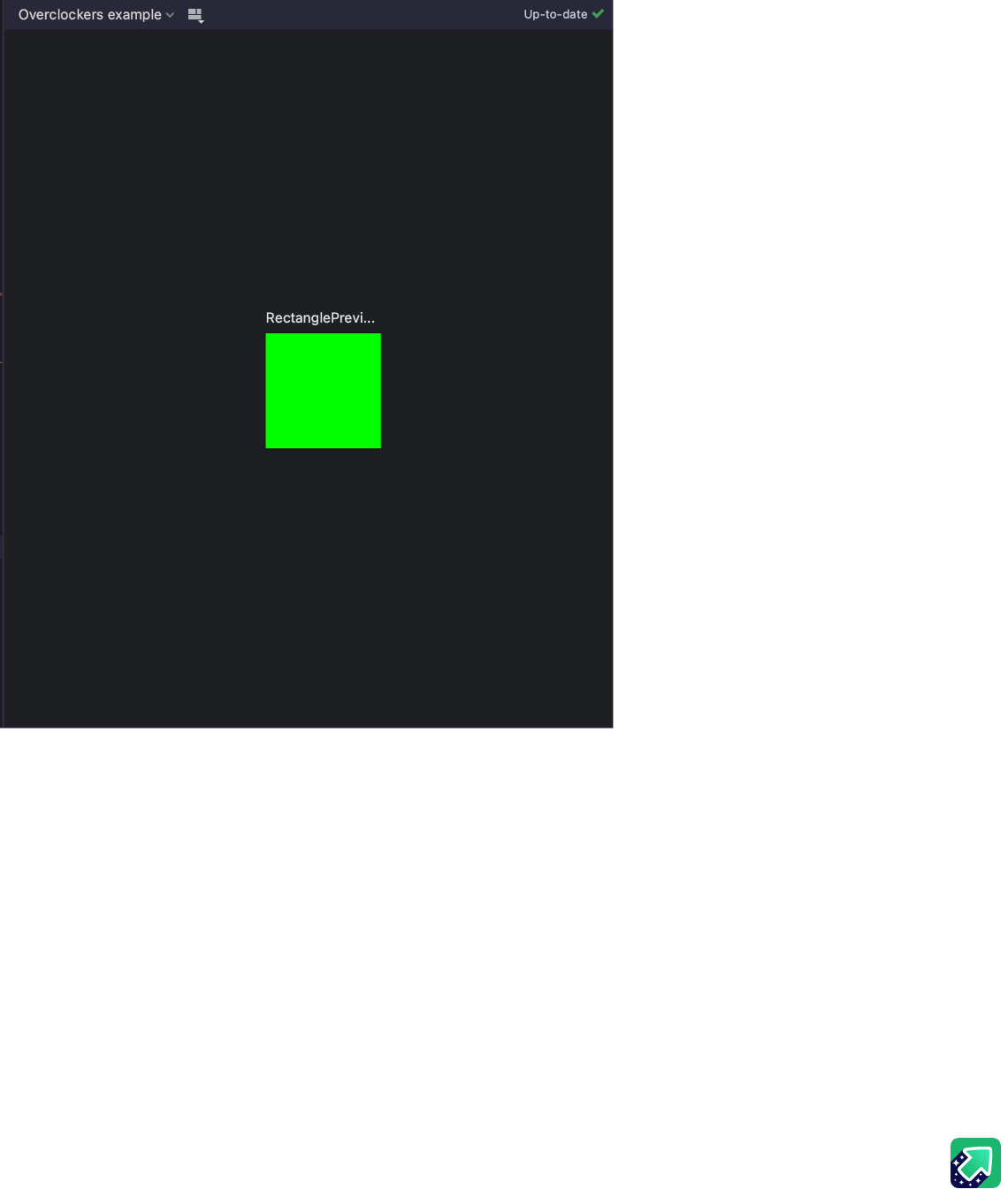

The simplest way to do it right now, in a brand new project, would be to use Jetpack Compose to draw a box, clip it to the Rectangle Shape and set the color to your RGB color like so:
Code:
val color = Color(0, 255, 0, 255)
Box(modifier = Modifier.size(100.dp).clip(RectangleShape).background(color))
Thats the bare minimum and you'll see a preview like this:
Reason I said brand new project is because if you're wanting to add a rectangle to a view in an existing project then your project might use XML views opposed to Jetpack Compose since it's relatively new. I'd recommend looking at this stackoverflow post which creates a drawable, then you create a view in your XML which background uses the drawable.
