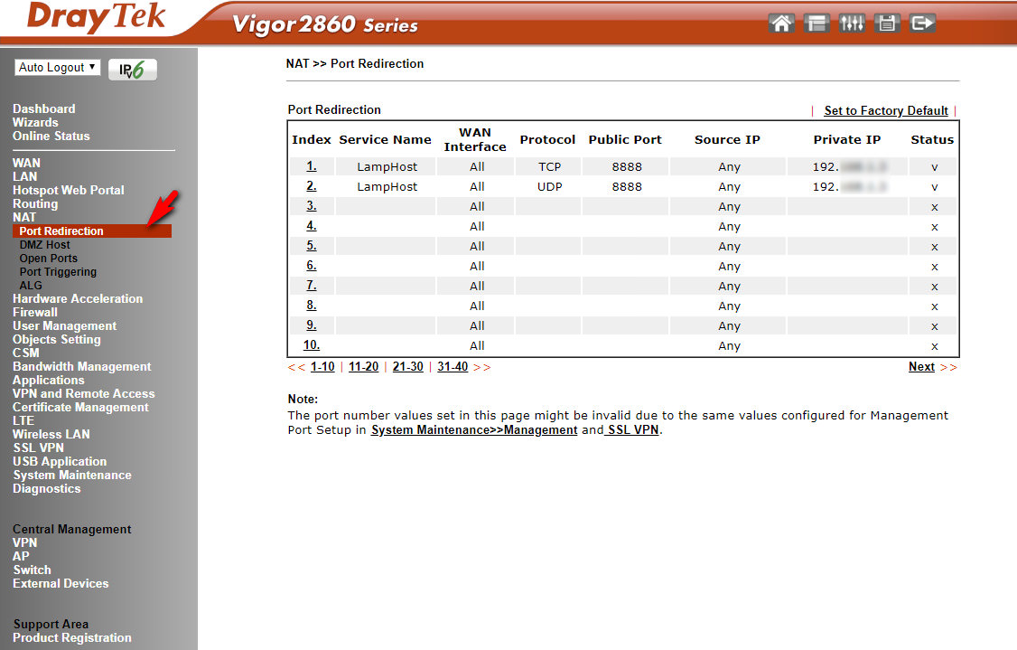

The first thing I tried was port redirection. You can see below I specified a public port of 8888. It wouldn't let me use port 80. I don't mind having inbound traffic arrive on 8888, if this makes it slightly more secure.
However if I try:
http://164*********.drayddns.com/test.php
http://164*********.drayddns.com/test.php:8888
none of these work from outside the LAN.
