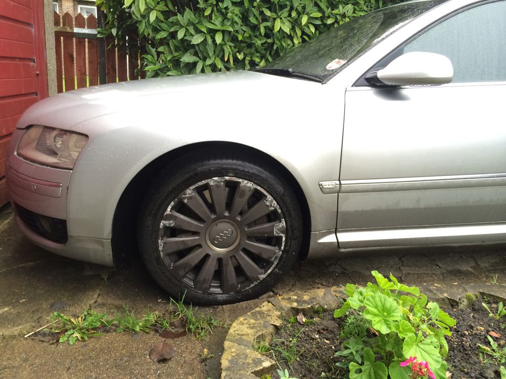

Last time I hit a curb this happened :eek:
IMG_4897.jpg~original
That alloy got chopped right up :O
