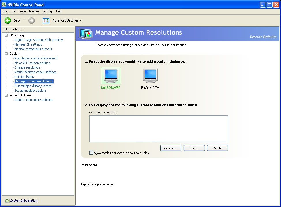

You need to be using the 174.74 beta's to use the new custom rez option, link below.
http://www.nvidia.com/object/winvista_x64_174.74.html

Go to View > Advanced and it'll be there, if not then define a custom one.
What driver version do you have? that doesn't look at all like mine using the 137.17's.

edit: installed the drivers RavenXXX2 posted and now everything is fine. 1360x768 is available now.
