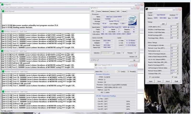

A word of warning though. X38/48 is bloody terrible for clocking 45nm quads. My DFI is fsb limited to just under 442 yet with a dual it easily does at least 520. It's a shame because this Q9550 is doing 3.6Ghz with stock volts.

I easily had 520 out of a Asus P5E and the same on my DFI with a E0 stepping E8500 but this DFI is useless with a 45nm quad. Currently stuck at 3.62Ghz and even that's taking a lot of tweaking with the board voltages. It will do 441.7 but it takes a hell of a lot of voltage on the NB and others to achieve this. The quad is running at 3.6Ghz on stock volts so it's a good clocker. Seriously considering swapping the boards in my rigs over as the other rig has a MSI P45 Platinum in it with almost as many options in the bios as the DFI.
Yep, i seen that Greebo had a similair issue with a q9650 in an x38, iirc he switched boards for a gigabyte P45, 3.6ghz on stock volts is what mine was capable of as well (1.200 vid) though i did run it on slightly higher volts at 3.8ghz.
I have a P5E with a Q9650, people are right X38s do struggle abit with this chipset on the quads, got mine at 445 nice round 4ghz, will do some more if needed but not much but certainly needs the volts to do it.
