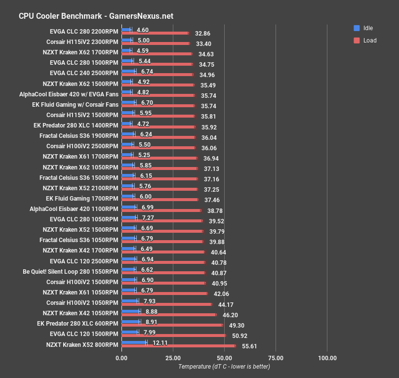

Have a look at this from gamers nexus:
Id say they would be a pretty good source on cooler performance. The stock Eisbear on there isn't doing too well but it looks to do well with some decent fans. I dunno for me id spend a tenner more on an nzxt or a corsair. Im sure ocuk wouldn't have an issue with swapping it over if you wished.
