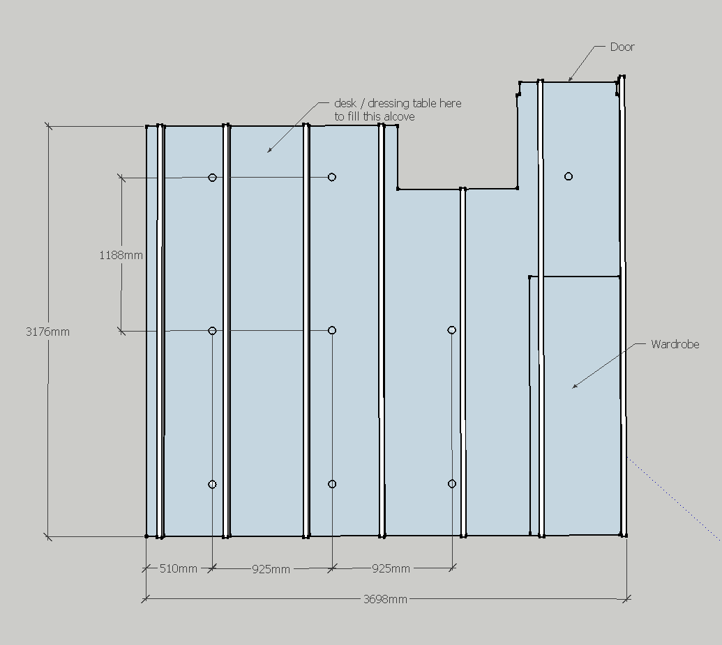

Next on the DIY project list is some downlights in the master bedroom. We currently only have one pendant and it's insufficient light, so I'm looking at installing 6 downlights with dimmable LED bulbs, based on this sort of layout:

  • I want the far two LEDs to work off one gang, and the other four over the bed area to work off the other gang. Will using only two bulbs off one gang cause any problems?
  • Is there a recommended distance from the wall that each downlight should be placed?

  • I looked for an answer everywhere and could not find one. Survey the joist locations before you decide anyway as it's likely you wont be able to put them in an 'ideal' spot anyway. I have them as close as 35cm away from a wall - it was a choice in a way, because the only other option was over a meter away. I kind of like ot see the hotspots on the walls and you get a some bounced soft light from them too. The only guidance I could find for layout was one fitting per m2, I've not managed that yet!

Regarding spacing and placement, from the highly scientific method of tapping the ceiling, I think I'll be OK, but will get up in the loft tomorrow and check.

Cheers for that. I've decided to put four bulbs on each gang, to overcome the low load problem caused by having only two LED bulbs on one of the gangs. Seems that the Varilight V-Pro (sold by Screwfix as 'trailing edge') are the ones to go for, as recommended above.
