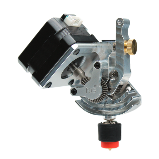

This is going to be a collation of the upgrades I'm doing for my Ender 5 in case anyone else wants to see the pitfalls.
it comprises of two main things, firstly Micro-Swiss NG REVO Direct Drive Extruder:
Endorphin 3D
half core XY conversion. moves the stepper off the Y axis to the frame.
I'll also upgrade to klipper at the same time.
