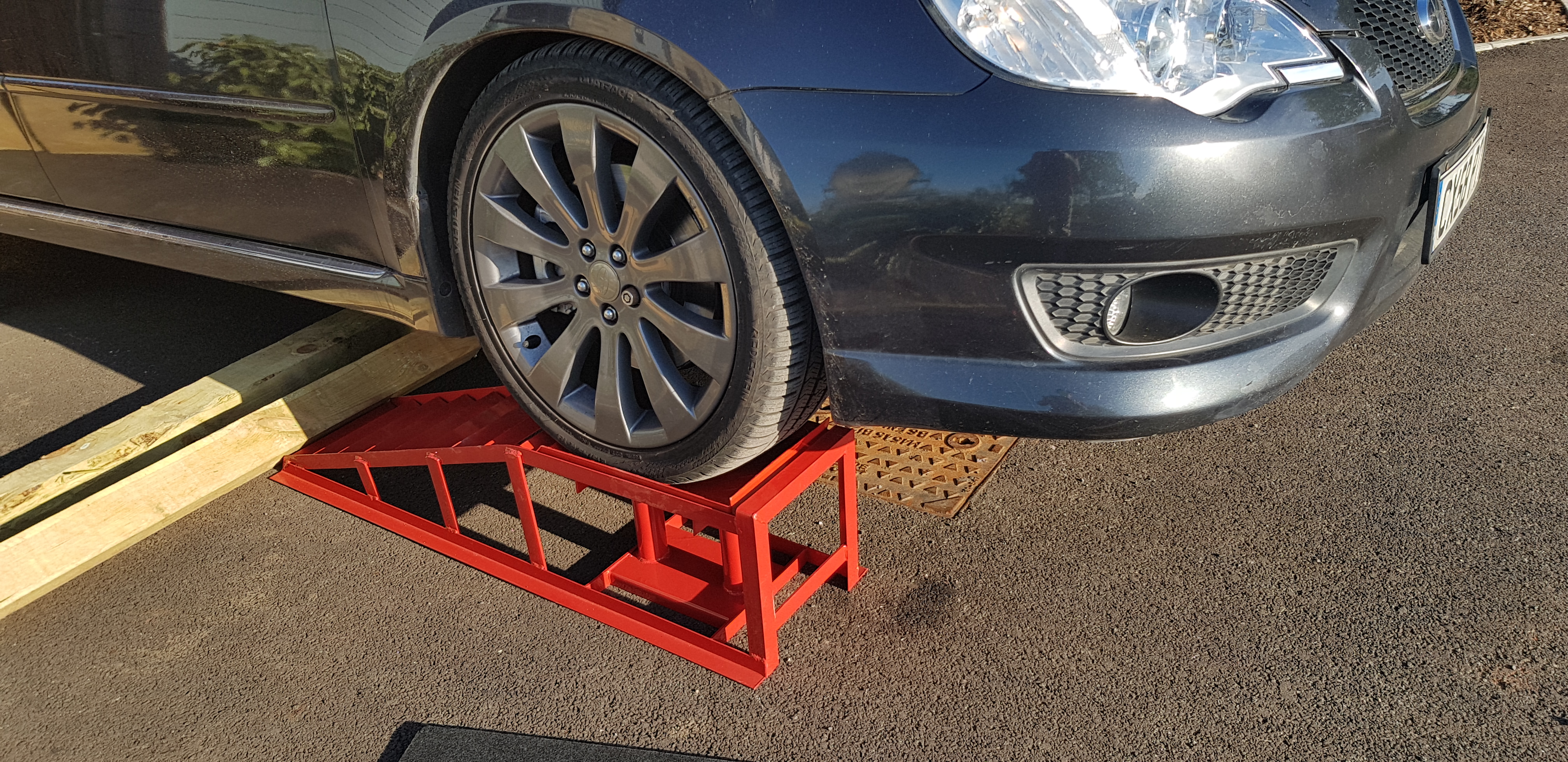

This is a ramp i used, the Subaru is a heavy beast but 1 ramp was sufficient, I just dropped to a level ground after to check the levels were correct

Edit: I've had a couple of ramps but more recently found some plastic ramps on eBay £50 for a pair they are better than the metal ramps. I'd avoid jacking up if you can for servicing only as you need to get your entire body under, it's also more stable.

I'm not keen on ramps. I prefer a jack and axel stands and ideally lifted up on both sides. Yes, it's more faff but many moons ago I had a ramp get stuck whilst trying to drive onto it (most likely operator error as I didn't use blocks of wood), there's also surely a risk of driving over it as well - although to be fair, the ramps shown above look pretty decent as there seems to be a plate that takes the resting weight. Mine are not as fancy but they're also sat gathering dust. Jack and stands have lower risk IMO as long as you lift and place the stands in a suitable position (usually a chassis point or subframe rather than the sill).

That ramp is this one, really good quality from Germany and its hydraulic so can also increase the height, far better than a jack and stands IMO - you do need some access ramps to mount onto it as the bumper will scuff it, well mine did.
