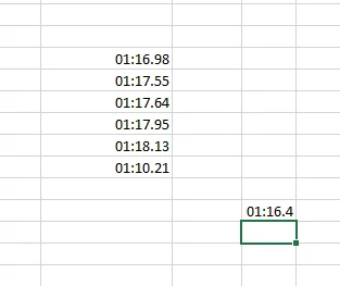

First thing I tried.
Result was 00:00.0
Works here:
Excel Format must be set to Time\Custom mm:ss.00
Screenshot above had the result cell set to mm:ss.0
Now getting #DIV/0!

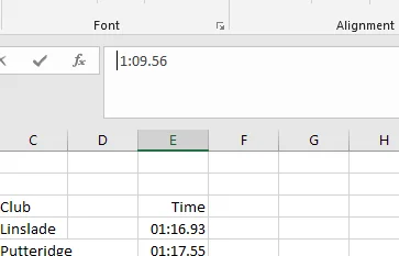

The Excel file posted by @Entai is completely ignoring any alteration to the formatting (at least that column is) which suggests it's locked open some formatting from wherever the values came from. I copied them out as pasted values, got the formatting to mm:ss.00 and then pasted back to ColE and the average updated.
Thanks, I see some others in there now but I've got it working. Out of interest, the original values, where they pasted in from somewhere else?
The original values were exported as a text based file, from a swimming race timing and results reporting package then dropped into excel.
I'd put a tenner on you just needing to put a step in the process to make sure you don't bring text that looks like numbers in then, looks like @Django x2 has confirmed the issue.
Oh, and if there are lots of times, and the total before you average them is more than 24 hours, use the format I suggested above.
You've answered my question then. White space. That tool is adding white space to the front of every time... You can simply click where the cursor is and hit DEL and magically watch the formatting change :)
