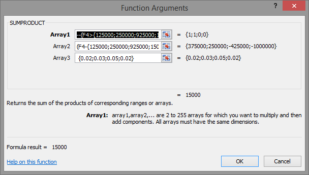

Sum them together and you'll pay £15,000 stamp duty :)
EDIT\\ Excel can present it better than i can:
