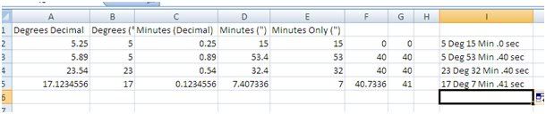

yeah thats what i have done though it quite long winded. the problem is seconds are time and there are no decimals in time.
Im sure there must be an easier way.

Yeah that’s kind of what I have done, thou your looks a lot neater and a lot less columns.
Going to see if I can tidy mine up in a bit and get it looking as tidy as yours

lol just kinda got it working myself apart from the last column.
I had it so the data now started in A3 instead of A2 and the cells B2,D2 & G2 contains Deg, Min•, Sec respectively as is the only way I could think how to get the answer but it is not working properly.
In the answer box I used the following code
=B3&$B$2&D3&$D$2&$G$2&G3
Was getting 5 Deg 53 Min•399999999999999999999999Sec which aint really any good. I want 5 Deg 53 Min.40Sec. I dunno why I was getting this as G3 = 40
thanks for your help mate got there in the end
