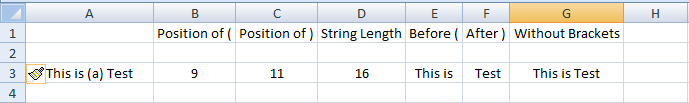

Is this what you mean?
I'm uploading this solution now and you can examine it to see how it works. I'll explain anything you can't work out.
Edit: Here it is.
Hmmm.... I didn't take into account that there are two spaces, one either side of the brackets, yet the final string seems to only have one space between "this" and "test". If it is a problem though it's easily rectifiable by simply adding 1 to the before brackets part.

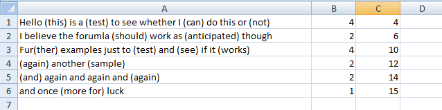

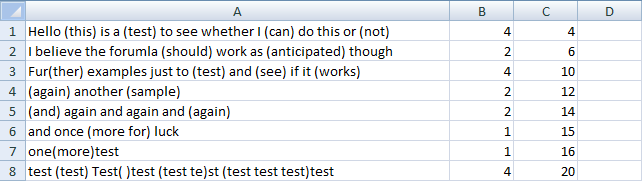

I've got the brackets thing working in my tool now - I'm just trying to adapt it so that it can remove multiple sets of brackets. I've realized that to do this I need to keep inputting the result into another set of the same formulas - the thing I can't work out is how to get the 'Results' field to display the final result (when there are no longer any brackets within the text) because if the result is put through the formulas again after the brackets have all been removed the result of the formulas is just "#VALUE". I think I need a formula to determine when all the brackets have been removed and then display this result. Any suggestions are welcome!
If you need me to upload the example let me know and I will do 2mo!
Thanks again,
mrbest

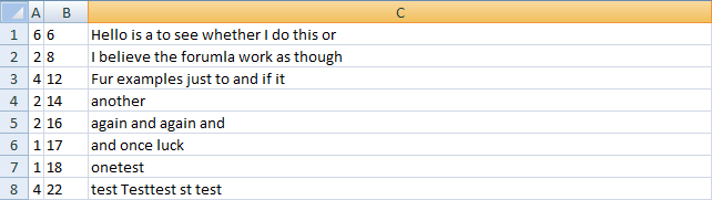

Hey Antar Bolaeisk,
I've been meaning to get back to you about this but I've been well busy! Thanks again for your great input and for sharing your time to help me. What you posted before was great, the only problem was a lot of the functions aren't supported by the version of excel I'm using. However I was able to fix the multiple bracket problem in a less complex way. I'll post the excel file up here tomorrow so you can see how it worked out. Hmm you say you may have a solution to the space problem? That may still be useful...
cheers,
mrbest
Hey Antar Bolaeisk,
Here's the tool I created. The formulas are hidden to the right of the input fields.
