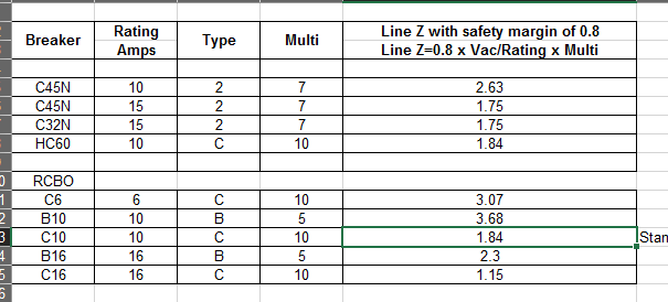

main spreadsheet:
limits:
basically what i'd like for ease of reading and without having to flip within different sheets.
to highlight column N (line Z)
if it's over the limit based on the breaker that's used in column O
In the limits table column A isn't unique, e.g. C45N appears twice with two different ratings and therefore two different safety margins. That table needs a unique identifier. I would suggest adding a new column in before Column A called "Unique Identifier" (or whatever you like) and the formula would be something like =$B5&"|"&$C5&"|"&$D5 which would display C45N|10|2.
After doing that, in the main spreadsheet highlight Column N and add new Conditional Formatting with the formula:
=$N1>VLOOKUP($O1&"|"&$P1&"|"&$Q1,limits!$A:$F,6,FALSE)
The yellow text is the sheet name of the limits table, you'll probably need to edit that. If the data in column N is bigger than the corresponding limit in the limit table then the formula returns TRUE which triggers the conditional formatting (which i assume you'll set to highlight red or something).
