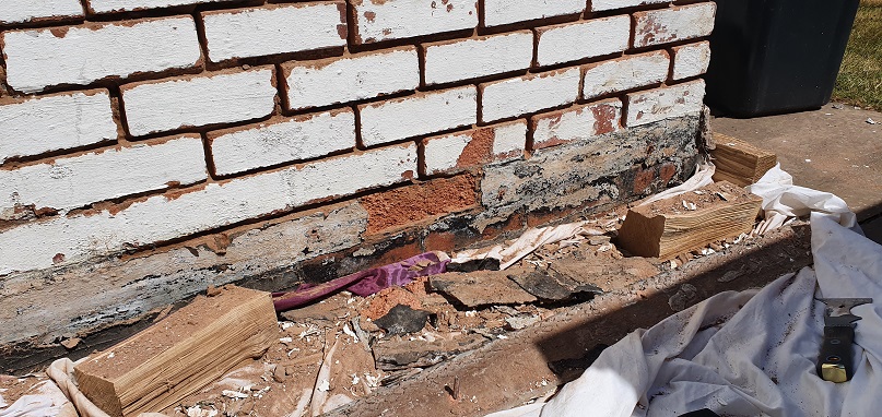

Well started this in earnest weekend just gone... Have taken it upon myself learning how to re-point brickwork. I went the plugging chisel route - more control for me and less chance of damaging bricks. It has been backbreaking working on what has been a very hot weekend - but also good to make a start and actually feel like I'm doing something constructive rather than just reading about it... :D
Which has lead to discovering I need to repair some damp proofing below the plinth thing as I've ripped it off. There's other damage to this layer all around the house - cracked render/brickwork. So think this will be my primary target for now. I've plugged 4-5 courses of this rear wall, probably more than I needed to, but won't need to do that elsewhere. Plan tonight is to mix some mortar and actually repoint it.
See how tidy I can get that done, then consider if I'm going to knock out that spalled brick (term where the water has compromised the front of the brick and it blows off) and replace it. It sounds simple enough to do...!
