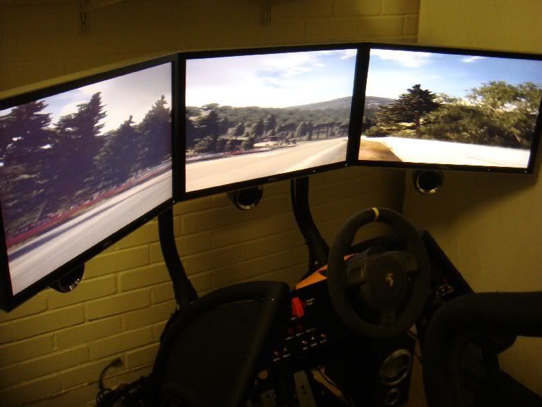

I've had both. Ran a TripleHead with a 4870X2, max res was 5040*1050(they updated the firmware for this). Now running a 5970 at 6016*1200.
TBH, apart from the resolution there isn't a difference that I could see in the image quality etc. The main difference is price. I just sold my triplehead for £95. So if you've got cards and are happy with the resolution, its a good way to go.
But if you've got the money then a 5xxx series card (+ cost of DP adapter) is a better longer term solution for higher resolutions.
Oh, the other difference is bezel compensation that has been included in the Catalyst 10.3+ drivers, whereas you had to rely on game support for bezel compensation on the TH2GO

Naturally the higher the resolution the lower the setting you must employ to run decent FPS. AA is the main thing I need to turn down, still I cant tell any significant differance most of the time between 8xAA and 2xAA. I was the same, wanted max settings all the time, but the immersion from the Triple head far outweighs any reduction in quility setting you may need to employ.
I'd agree, that you will have to comprise with some settings mainly AA when your running a triple head resolution, and maybe some items like shadows, but it's on a game by game basis. Even though I'm running a 5970 you can't max everything to ultra in settings when your running a 6016*1200 resolution.
But I'd go with a lower setting anytime to get my 3 screens over 8*AA.
