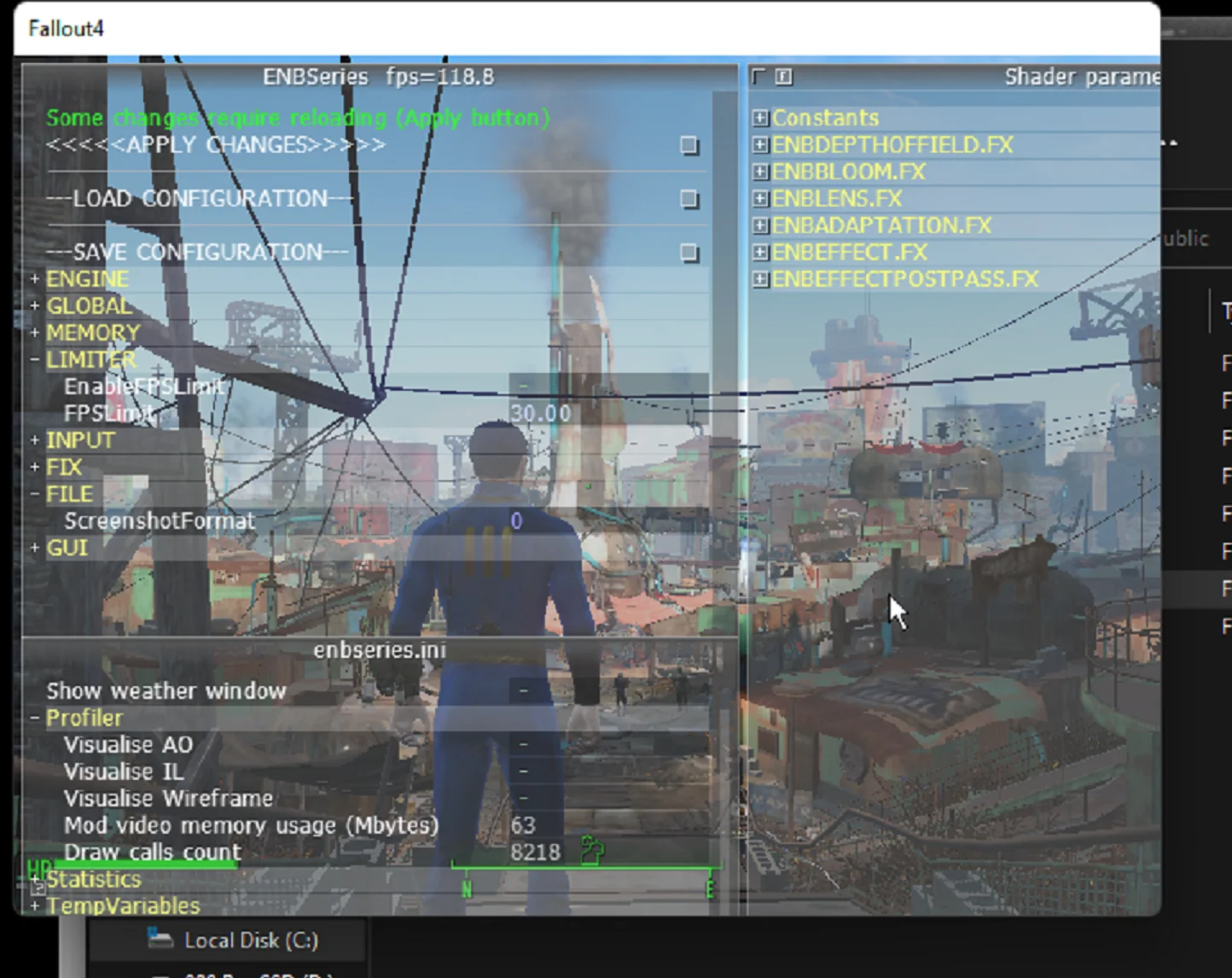

Once you have done all that start up Fallout4. There will be two saves - the Corvega Plant and Diamond City.
MajinCry in Anandtech thread said:
And once you're in the game:
1. Load the save(s)
2. Press Shift+Enter to bring up the ENB overlay
3. Click on the "Profiler" category. Pan the camera around until you get the same number of draw calls, as the number in the save. So for "Corvega11700draws21fps", try and get as close to 11700 draw calls as possible. Same gig for the DiamondCity save.
4. Note down your framerate, and number of draw calls.
For the Corvega save pan the camera around until you get 11700 draw calls and note the FPS. In Diamond City pan the camera around until you get 8000 draw calls and note the FPS.

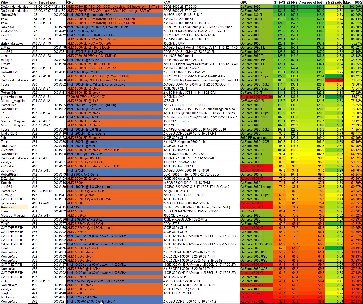

Current leaderboard(18/04/2023)

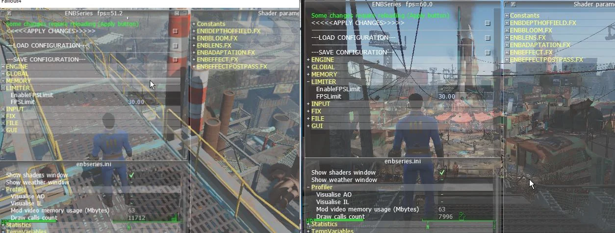

Here are my preliminary results:
Radeon RX 470 4GB:
OS Windows 10 x64 21H2
CPU Ryzen 5 3600 stock
RAM 2 x 32 DDR4 3200 16-20-20-39-74 T1
GPU Radeon 470 4GB
GPU driver 21.10.2
ENB Version enbseries_fallout4_v0461
Corvega Save: Drawcalls 11,712
Corvega Save: FPS 51.2
Diamond City Save: Drawcalls 7,996
Diamond City Save: FPS 60.0

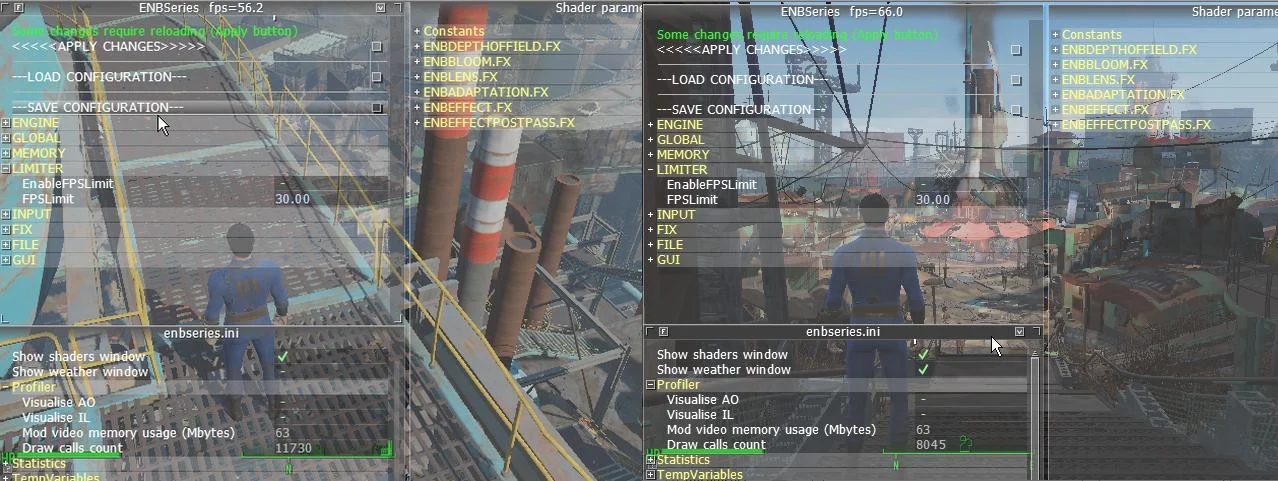

GeForce RTX 3050 8GB:
GPU GeForce 3050 8GB
GPU driver 511.32
Corvega Save: Drawcalls 11,730
Corvega Save: FPS 56.2
Diamond City Save: Drawcalls 8,045
Diamond City Save: FPS 66.0

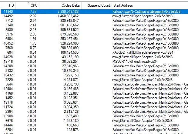

I did run it again (same score) but this time I had Process Explorer running and looked at threads:
So the one thread (TID: 11840 in my run) does most of the work.
The second one does about half of that, the others are way behind.
No idea which thread does what but it looks like while Thread#1 limits things, the rest could scale up to about 9 threads.
My 3600 ran at a steady 3.95GHz.
EDIT: what was supposed to say "any" not "and".

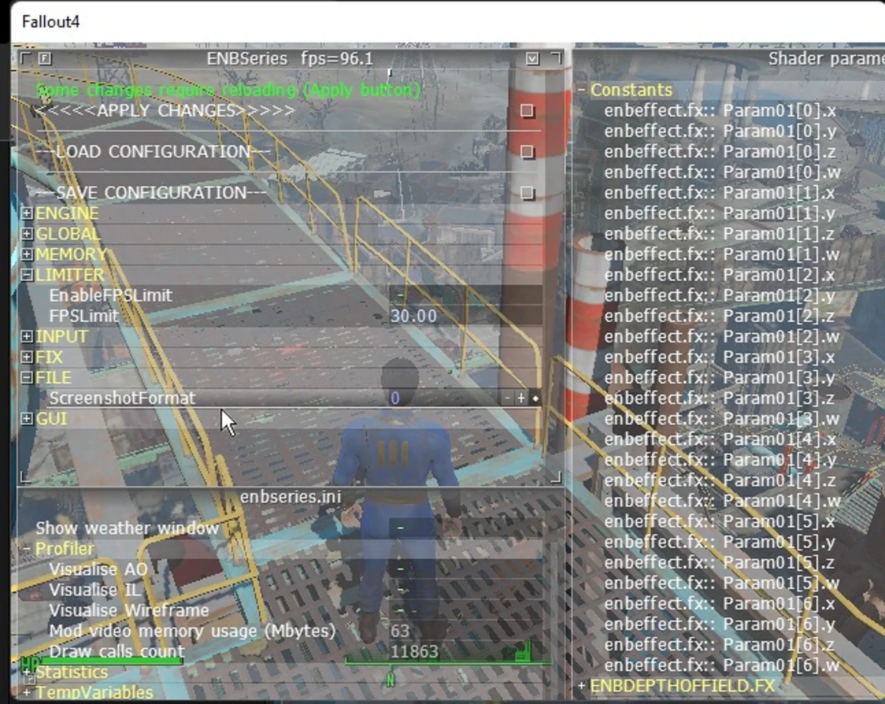

12600k tuned with a stock 980ti and bdie tuned as well:
Ooh!! Some really nice scores there and thanks! What clockspeed was the Core i5 12600K at and what speed and timings was the system RAM at?

Looking at some other comparisons for Fallout 4 performance,Skylake appears to be slightly ahead of Zen2 clock for clock(A Core i7 6700K was slightly ahead of a Ryzen 7 3700X in per clock performance). Looking at some reviews,performance seems to tail off after 6C.
28 Sep 2018
2,267
Here you go:
https://cdn.discordapp.com/attachments/808239707103821844/936018896866115614/unknown.png
https://cdn.discordapp.com/attachments/808239707103821844/936019185237131284/unknown.png
