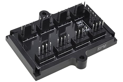

What you want is a 8X pwm PCB splitter,they are usually branded by phobya and modmytoys over here,google them and you will find them only cost £5-6.Each channel can provide 20w(it might be 30w actually) so just get some regular splitters and hook up 2 fans to each channel,then control the pcb via the cpu header.

Speaking of fan splitters, avoid modmytoys like the plague, they are incorrectly built as they connect all RPM signals together.
I have a bunch of those splitters, they are ideal!
