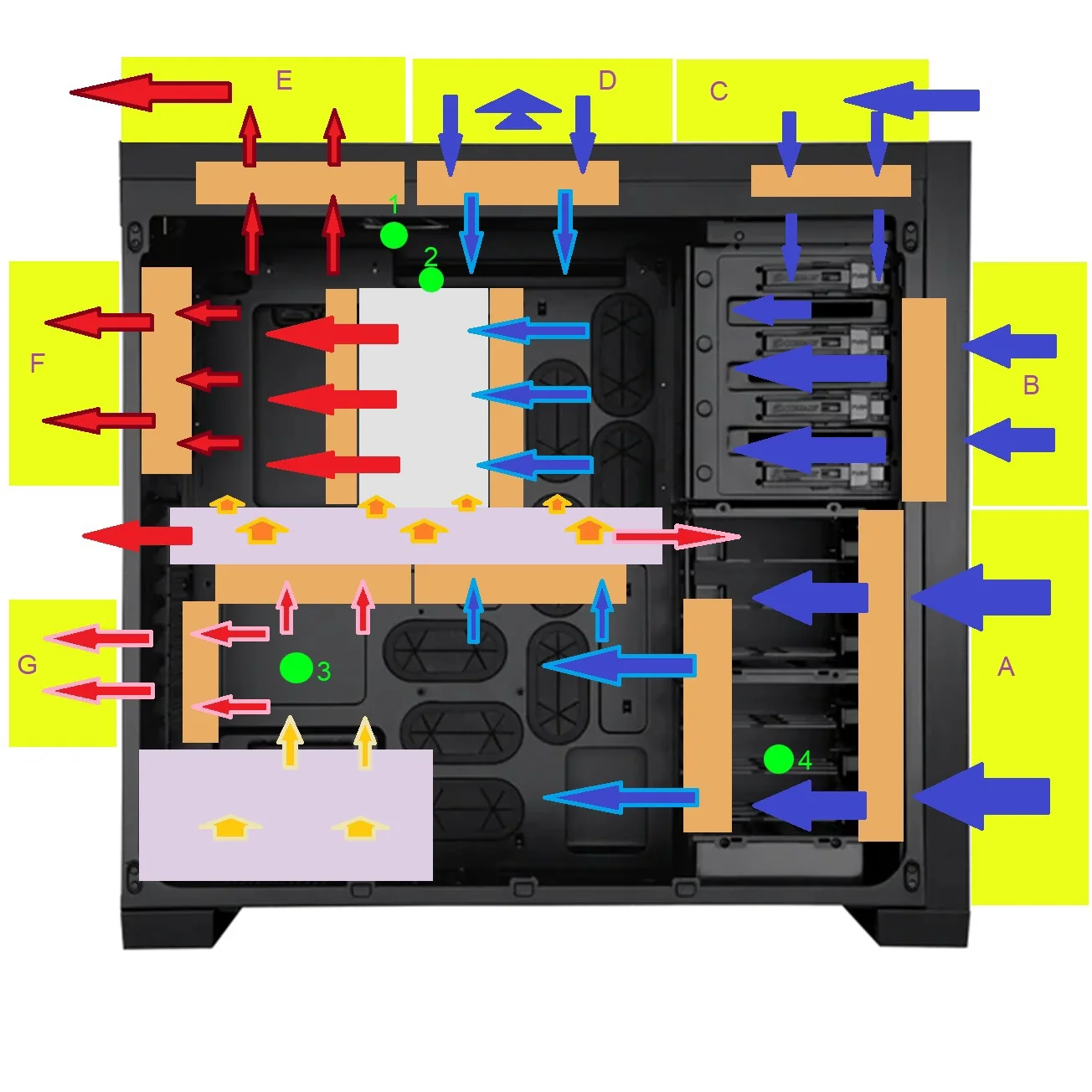

If you're interested in other setups, I'll get a mockup of my main rig up later on so you have stuff to compare with.
:: edit ::
Here we go:
The numbers in green are at temperature probe points. I use them to get an idea and to keep tabs on temperatures inside the case along major points of interest: 1. Air Temp above CPU Cooler. 2. VRM Temperature on Motherboard. 3. Air Temp between PSU and GPU. 4. Intake Air Temp.
A through G are fan mount locations and also "shrouds" that I have added over these fan mount points (because fan mount locations allow sound to escape as well). The shrouds have been added with some foam inside them in an S duct style of layout to help baffle "some" of the noise that may escape. Intakes (A, B, C and D) all have a mesh filter in front of them as well (fans, not the shroud; the shroud covers over the filter though).
As you may notice in my setup, I've got the D and E fan locations identical to how you setup originally. This was done because this case (Corsair 650D) does not have enough airflow potential in its original design, and the motherboard VRM I have (Rampage IV Extreme) is very prone to fluctuations if temperatures rise too much (CPU under extreme load), so a more direct cooling solution was done to make it easier to keep it under control. This also then doesn't compete with the CPU cooler by exhausting cool air coming from the front of the case (on the right of the image) out before the CPU Cooler can get to use it. To prevent recycling of the warm and cool air, the shrouds also vent and direct air from different directions. This also has a minor benefit of making any escaping noise to be "slightly" diverted to a different direction, masking and reducing noise that is perceived.
The shrouds were made from cardboard and foam (incidentally, boxes with the ocuk tape on them, so it looks cool I guess :p) so nothing fancy and cheap as heck, but does the job well.
This setup allows the system to be "silent" in the middle of the night (15-25cm distance from case needed to hear the fans whilst straining your ears whilst gaming). Certain CPU intensive tasks or ultra heavy gaming can be done even at this low volume level, but the motherboard VRM is just fickle, and so will require slightly higher fan speeds from Intake D to keep it from throttling and crashing the system.
Thanks for the detailed reply and setup. Aye as you say it's similar to my previous setup but I think my metal mesh filters were not allowing the top exhaust fan to exhaust probably without ramping up the rpm and subsequently creating too much noise.
Is that a fan you've got installed between point 3 and G? It's an area of concern that I noticed in my setup as I don't think I can get a fan in there but it's an open mesh, so I decided to change my setup to positive pressure and therefore making this point a passive exhaust area.

Ah. That's unfortunate. The top of my case is just hole punched rounded hexagonal holes and not a mesh, otherwise I may have ran into the same issue you did.
It is yes. I found that when the GPU fans go from zero RPM mode to active (40% fan speed, swapped the original fans with two Noctua A12x25s) and when that happens, that forces warm air all around the case and sort of "pushes back" against the incoming cool air from the front of the case. To help circumvent this, I placed a Noctua A14 (spare) at that location so when the GPU fans do kick in, more of the air is being directed towards the rear and top of the case, where there are fans helping to exhaust them out.

The mesh filter at the top of my case is that magnetic removable kind, but it's the whole length covering both fans so not ideal. Thanks for the other info, food for thought.
Because of the length of my case I am a little worried that my front fans aren't pushing enough air to the rear of the case where the graphics card is, unless I up the rpm and make it noisy. So I used my spare 140mm Alpenfohn Brocken 3 fan and installed it (via magnets to the rear metal of the case) perpendicular to the graphics card (well, there's a very slight angle towards the rear passive exhaust) so that it blows into the area in front of the graphics card fans to be sucked in.
I'm not sure if this will mess up airflow and I've not tested it properly but I've felt that this area between the graphics card and my Sound Blaster Z has been a bit of a hot spot.
I suppose the question here is, are there vents behind that new fan addition on the side of your case so it's bringing in cool air from outside the case? If not, you might be breaking the airflow and not really making things any better, because you're trying to take a straight flow of air and bending it 90 degrees. Someone more knowledgeable will be able to fill you in on the details on that, but I remember it's considered a no-no.
But if you've noticed a bit of a hotspot there and it is helping, I'd leave it be. Although I'd be tempted to see, if physically possible, to place it between the front fans and the GPU aimed towards the rear of the case to test if viable too. In theory, the fan won't need to work as hard because its getting air from the front fan, so all it needs to do is keep pushing it to the left/rear of the case. Any cards there, assuming the rear PCI plates are off, should attempt to exit that way more easily, whilst carrying heat away from the PCI area and bringing in more cool air from the front.

Yep, this was exactly my first concern. My old case had vents in the side panel and a fan mount, but this one doesn't and as you say there is air flow to consider. It is slightly pointing towards the rear but not enough to act as a push through I reckon.
My initial plan was to actually mount it in front of the graphics card just as you say to help push the air on, but I thought my PSU shroud was metal and turns out it isn't, so the magnets don't work. I'll look at using some double sided tape and stick a small piece of metal on it as I think it would be a far better solution.
I'm also wondering if there's heat soak transferring from the CPU heatsink. I've got a spare PCI plate above the GPU, I wonder if you can buy some sort of bulkhead/heatshield which can screw into that PCI plate in the rear of the case?
EDIT: Was also thinking about a PCI slot fan array but to go above the GPU and blow against the CPU heatsink therefore away from the GPU? My CPU and other temps are all good, it's just the GPU which is getting a little toastie when mildly overclocked.
I've relocated the fan so that it is in front of the GPU and being assisted by the front case fans, but I'm getting a strange resonance now which I'll need to deal with. It disappears when I remove the side glass panel, so I'll maybe open up the rear PCI slats again and see if that helps.
One thing I've noticed with these Corsair ML140 fans is that there's no direct airflow from the centre of the fans and it all seems to come from the edges and goes out at a bit of an angle. Airflow doesn't feel great when running at low rpms. When cranked up to 100% they are awesome, but also very loud.
The spare 140mm Alpenföhn fan from my CPU cooler seems to be much better at having direct airflow straight from the fan (could be the fin design?) and definitely pushes out more airflow at lower rpms and therefore much quieter. I'm tempted to replace my Corsairs with a few of these: link
