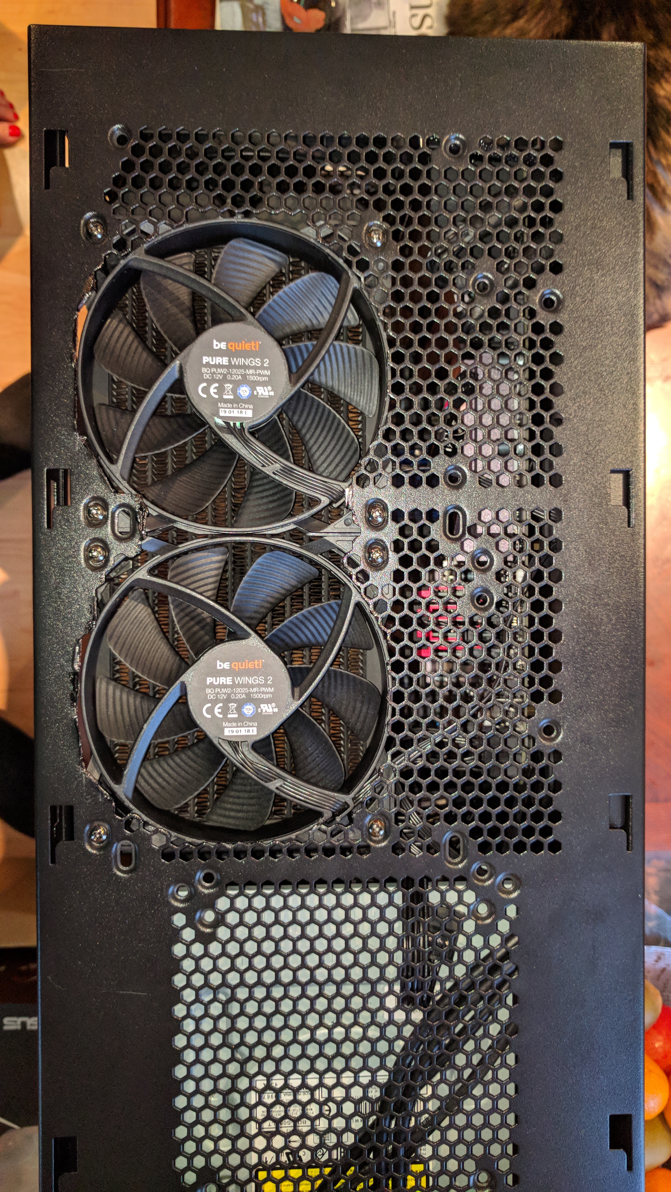

https://www.overclockers.co.uk/be-quiet-pure-wings-2-120mm-pwm-high-speed-fan-fg-03m-bq.html
2000 RPM / 65 CFM / 35.9 dB(A)
I'd guess they would be pretty quiet set between 1000 to 1500rpm
I use the older 1500rpm versions on my rad and I struggle to hear them even at full speed.
