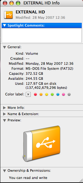

I've been happily mounting a FAT32 formatted 400Gb disk on both recently, just the one partition.
I think I may even have some files over the limit, but I'm not getting out of bed when I feel like crap to find out. :p

I first used mine straight out the factory, so not sure what they used to format it, then I split it in half, one NTFS and one Mac OS journaled. Then, I used Disk Utility to put it back into one FAT32 lump.
It does take about 30 or so seconds to spin up the drive and mount it mind you.
Have a picture.
Have a picture.
