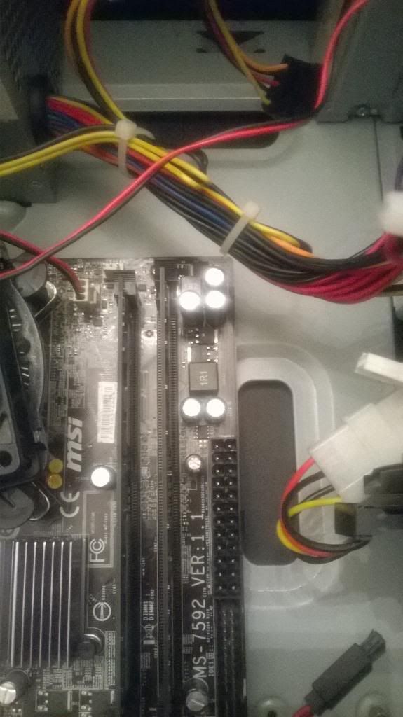

Hi, my pc has just turned off and wont turn back on,i have checked everything and everything seems fine, the 24pin connector is fully down, but when I put the 24pin connector 1\3 of the way in it comes on but when i put it fully down it goes off, now i have tried different mobos and other psu's and it does exactly the same, i have done the paper clip trick to check the psu and its all fine. I just don't understand why its doing it with a different mobo and psu. Could anyone please help? T.I.A

@ExRayTed, i have done everything right this is my 4th build, the power. Supplys work as i have done the paper clip trick and it was perfect (on both psu's), it could be the motherboards i don't know, i have just removed everything left just the mobo in and took the green wire out of the 24pin connector touched the case and everything booted up? So i just don't understand it.
Stick the image url in
