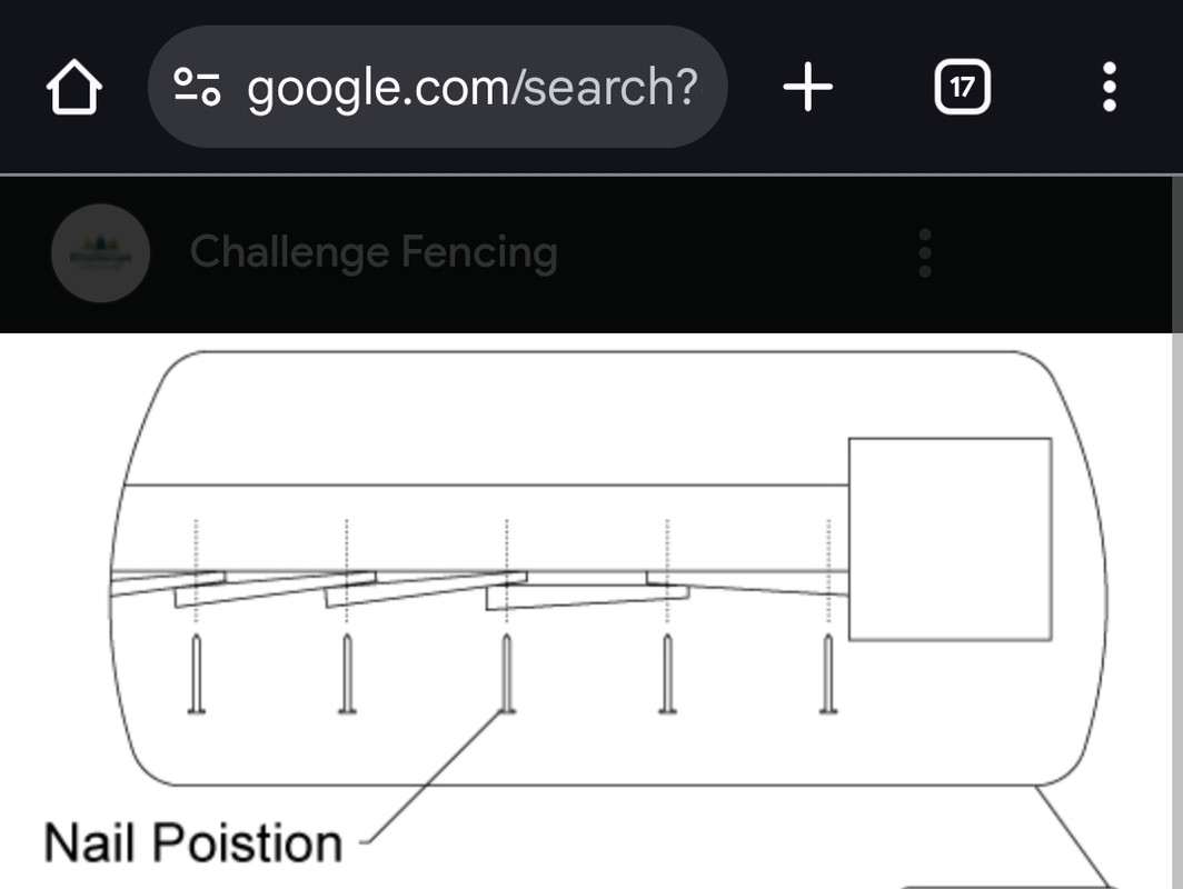

When ending the feather board, mines done as below, is this just so you aren't nailing the thin bit of the board, if you just kept going to the end.
It can be done either way, but i will usually only do it that way if the gap at the end is less than 50mm.
There is nothing wrong with it being done either way, its just personal preference.
wrong way
i was always told not to nail BOTH boards together as it will split one board due to different shrinkage
nail in the pic needs to be further to the right so not nailing the underneath board
and i always used to keepgoing same way till the post not as it is shown in the pic
just my opinion ofc
wrong way
just my opinion ofc
I've read and seen both ways for nailing the board, also some say only screw, but that must be so time consuming.
I think I prefer the 1 nail per board, due to shrinkage and expansion, makes more sense.
So many options :cry:
