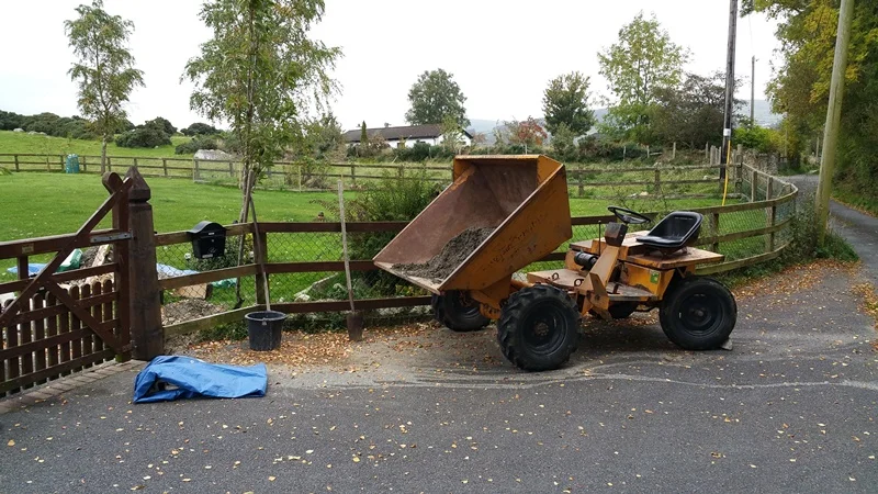

I'd say the postcrete is more than fine, but when your neighbour turns up out of the blue with a load of concrete in one of these - it would have been rude not to use it!
