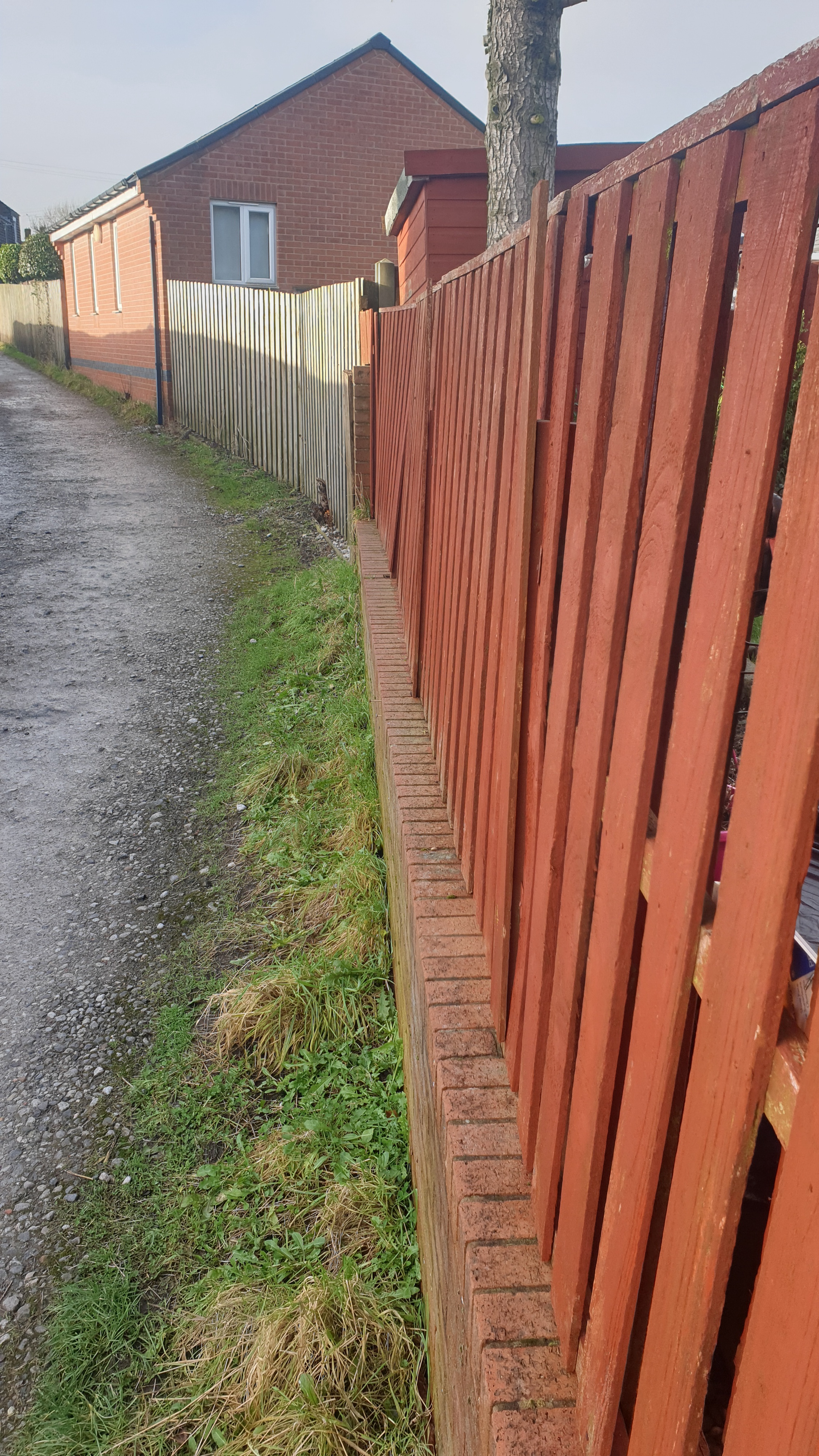

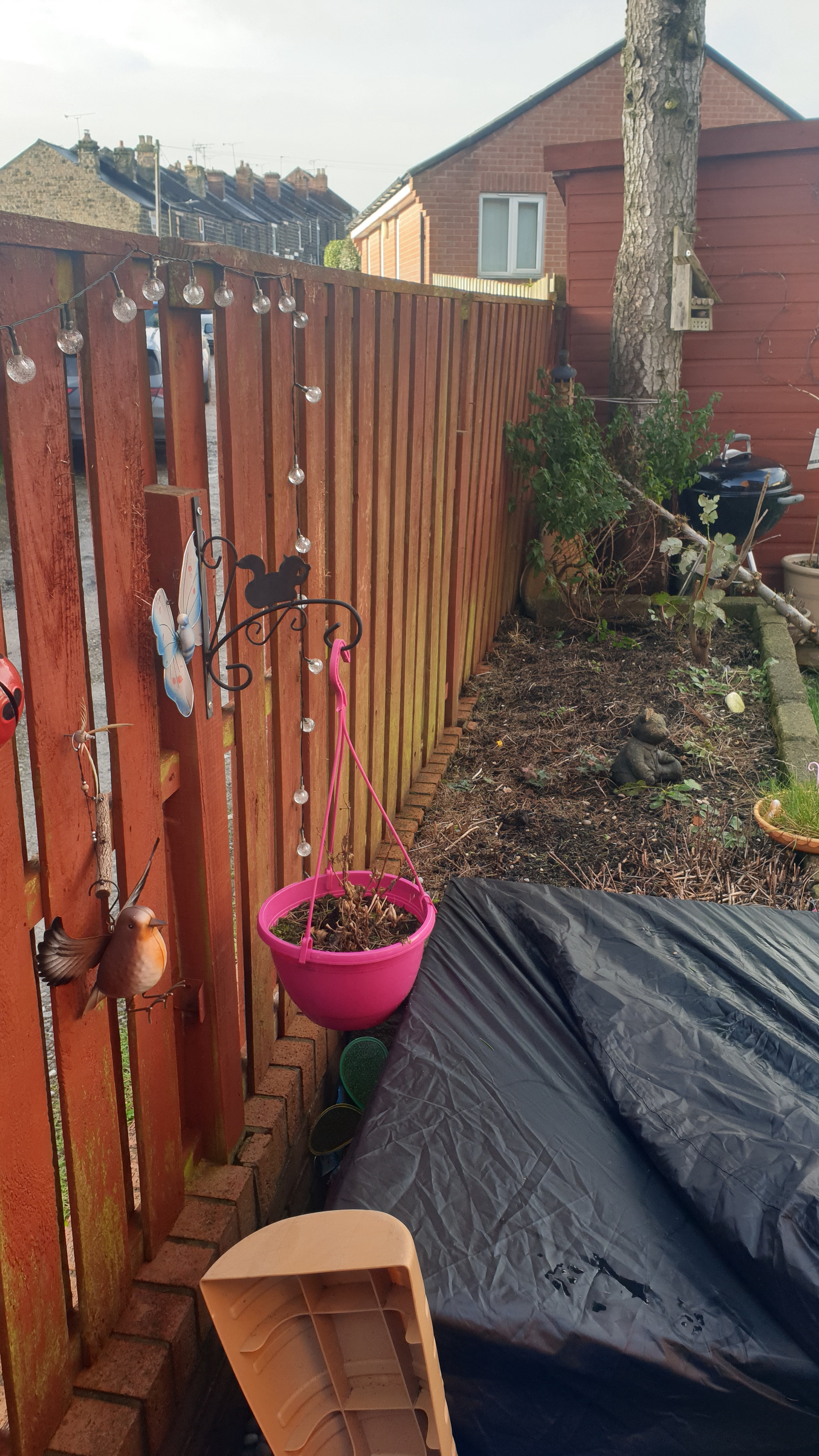

Got a fence run that is probably 30 foot in length or so.
on the side of my property against a un-adopted road

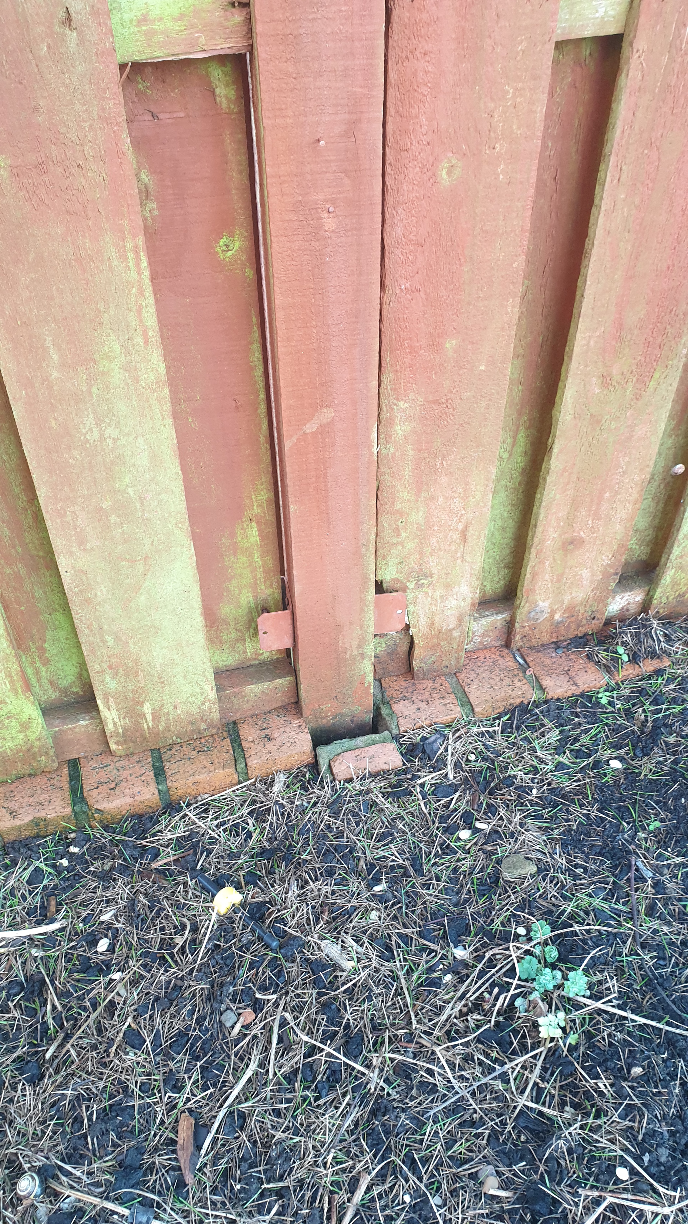

presently the problem is the fence posts are inside a 2ft high brick wall and the wind over time has battered the fencing and in turn pushed the bricks around the fence posts in the 2ft high wall, made them loose. So the wall is no longer 'holding' the fence posts in.
What is my best way to repair this do you think? I thought bolting some wooden posts on the wall from the bottom against the road side of my wall?
But I dont really know what is best. I thought bolting those metal fence supports onto the wall, but then I imagine in time, those bricks becoming loose as well?
any ideas please.
Thank you

The fence posts are moving towards the garden (away from the wall)
The hole is not very deep. I'd guess maybe 1 ft or so
I thought about concrete them in, but was unsure because of the existing depth and also would there actually be any room for the concrete
I would pay someone to put concrete posts in and the stronger panels. Anything else will take a lot of digging and lifting.
Yep, concrete posts sank to a decent depth and concreted in is the way to go, won't be the cheapest solution but will be really long lasting, ours was done during covid and not a single post has moved and the panels in them are all still fine despite being a massive wind exposed area
It looks to me like the problem is caused by inadequate support for the post on the garden side, i.e. just about half a brick's worth. This is the cause of the problem. On the road side, you've got the full width of the wall supporting the post, and that's why the post doesn't move towards the road.
The "quick and cheap" fix would be to dig a shaft down beside the post on the garden side, and fill it with concrete, as it's just towards the garden that the problem is, as the wall is holding the post on its other three sides. It's only really worth doing this if the bottom of the wooden post is in good condition, otherwise it could snap off because it's rotten. Or as dlockers has said, use a concrete support and bolt it on higher up, which might be a better solution as any rot in the post low down would be less of an issue.
