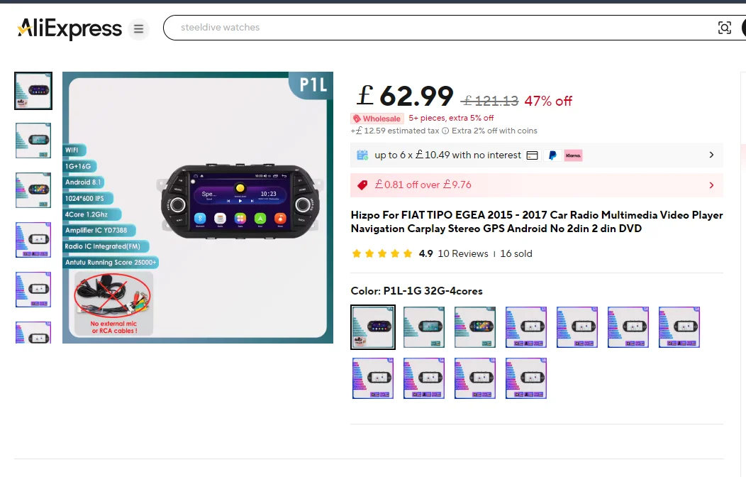

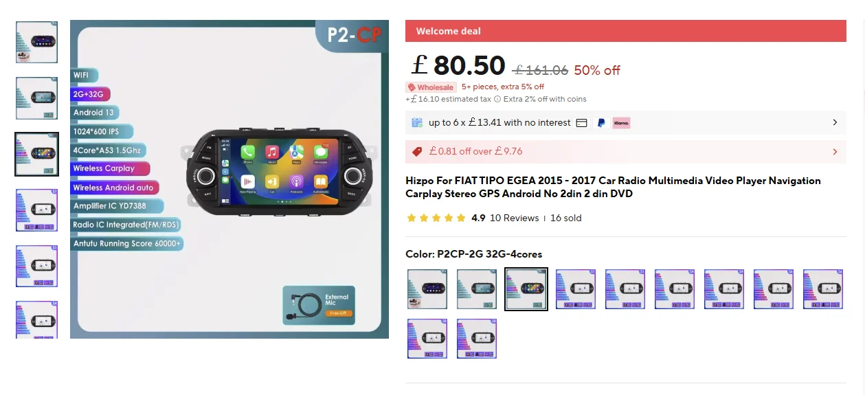

Note that one in the picture has *wired* Android Auto, if you want wireless you need at least this sub-SKU or higher, off that same link:
Thanks both. I saw these but was unsure how they would perform. Don't want soemthing that is slow.

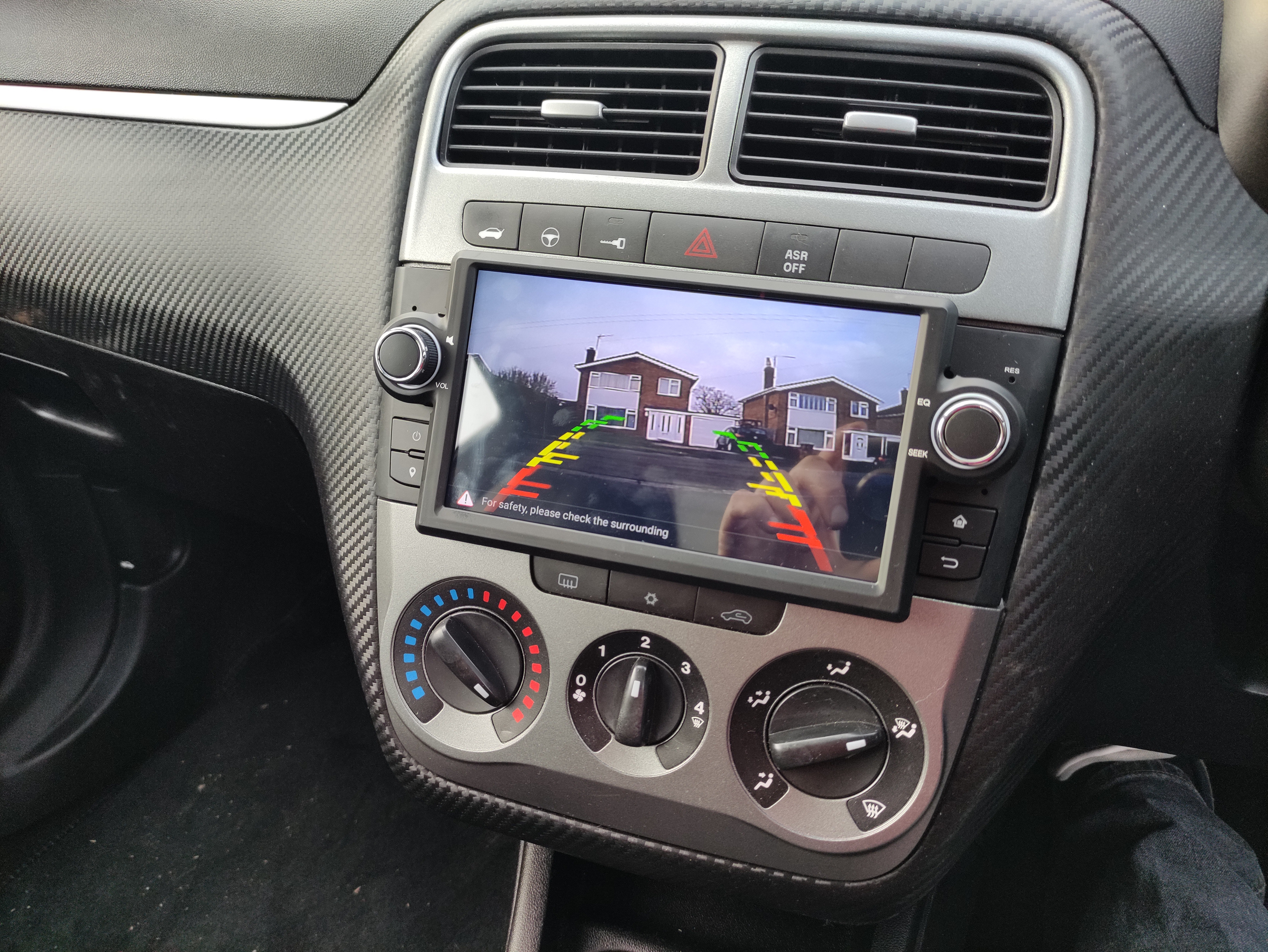

I got an Aliexpress for my daughters Fiat Grande Punto. Really good piece of kit for the £68 I paid. Steering wheel controls all work great and is wireless android auto. They come with their own can bus module so things like door openings and reverse camera all work without having to wire anything else in. All plug and play. Although you do have to run the wiring from the back to the front for the camera but not hard at all.
