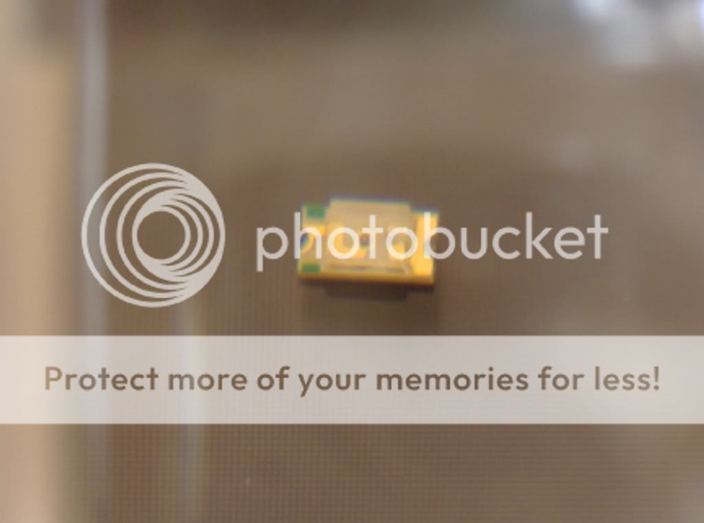

I have some 1206 sized ones in my drawer. They are just 3.2 x 1.6mm x 1.1mm in size and are quite difficult to solder by hand but achievable even with my nerves. The smallest available are 0402 and are only 1.0 x 0.5 and probably would be beyond my soldering skills.
Under a magnifier

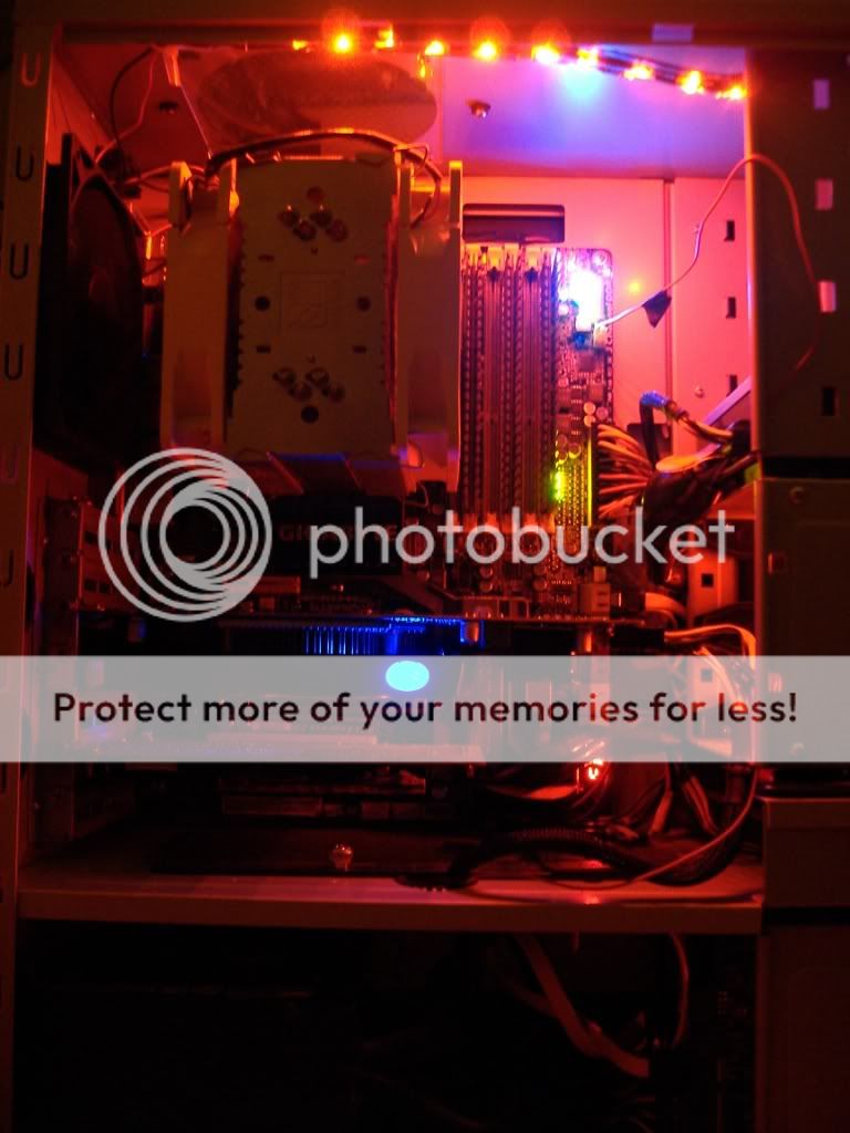

So after some chopping in half of LED strip I decided to have a little look how this thing would work inside my messy case.
I must say I wasn't particularly impressed in the daytime.
However once the ambient light level dropped things began to look a lot better.
Gives a very different lighting effect to standard LEDs. I think I would need to reposition the strip more to the left so it illuminates the other side of the HSF and perhaps another strip at the bottom of the case.

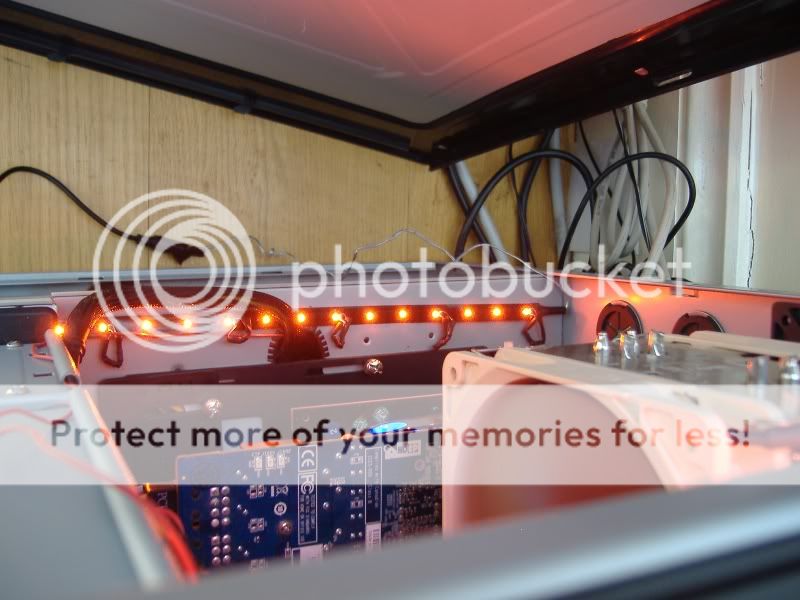

And 10 minutes later all done
Now Red LEDs are 1.8-1.9v @20mA and these Orange LEDs are 2.2-2.8v @20mA so at the moment with this 331ohm resistor they are running at about 15mA. I need these to be about 240ohm. (2.4+2.4+2.4=7.2. 12-7.2 = 4.8v to drop at 20mA = 240 ohm. Two 470ohm resistors in series with each other and in parallel with the 331 reaches about 244 ohm.
And you can see the difference it makes, the first 3 LEDs are running at 20mA and the others at 15mA.
Bit of an eye sore. I will be getting some SMD 240ohm to replace this contraption.

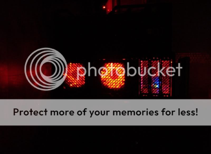

Bunged it in the case during daylight hours.
And in the darkness..
Switched off.
On
And finally the front of the case in darkness, with door open.

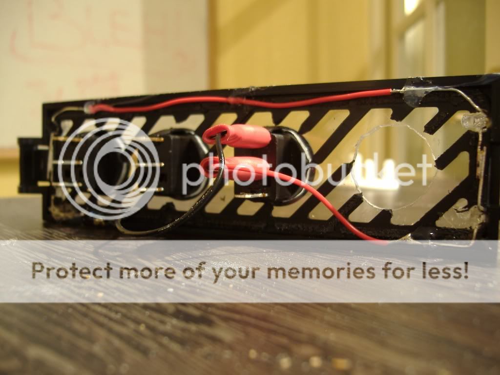

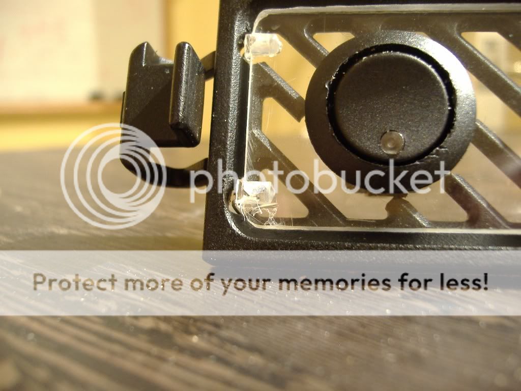

Seeing as I was using Acrylic I thought that I might as well light it up with LEDs. The acrylic I had was 3mm and the LEDs were 3mm so I drilled slightly offset to the rear side. Bunged the LEDs in stuck them with a tiny bit of hot glue. I had to drill a small hole in the drivebay cover to achieve this.
And from the rear.
The circuit is pretty simple.
It goes from the switched accessory position on the switch, anode to cathode through 4 LEDs and then I added the resistor (100 ohm) and back to the Ground terminal.
