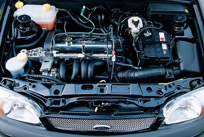

That looks more like a 1.7 Puma engine. Does your have the plastic airbox on top of the engine? If so you'll have a MAP (manifold pressure sensor) based system not a MAF. *edit looking at the year of your car you will almost certainly won't have a MAF.
Later engine:
Earlier pre 2001 (?)
it would be around a year 2000 model, looks exactly the same as my friend's y reg mk4 1.25.
Without a photo of the actual car it's kinda hard to help totally accurately.
