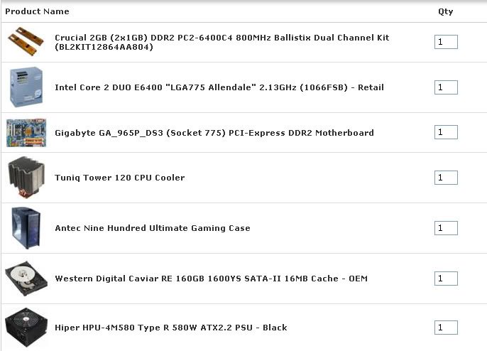

Just put throught my order tonight, see what you think is it ok ? (I have a GPU already)

Looks good apart from...
GET RID OF THE HIPER!!!
They have a really really bad rep, something from Corsair, Antec, Seasonic and Tagan will be so much better.
Hiper's that bad ?! Hmm maybe I can ammend my order if thats the case, dont want it failing on me, I thought it sounded reasonable enough tho ?

About 30 people+ on these forums have reported them blowing up, try searching
Hiper have non-existent quality control
Just searched yeah, it seems their not great huh :rolleyes:
I hope OC's can ammend my order for me tomorrow :confused:

A Corsair 520w is a very good substitute choice on the PSU front. If you want to save a bit of cash you could consider going for the Geil PC6400 C4 that has the same specifications as the Crucial Ballistix but that is probably less of an issue than the PSU at the moment, some Hipers are fine however so it isn't the end of the world if you can't change it. :)
Well I'll try and change the order tomorrow when OC opens, I'm glad you guys told me of the problems to be honest :)
I 'could' just try it but tbh, I'm not sure I want to risk damaging my new components.
Thanks again

That ram is old too and probably gone already if thats clearance.
No I managed to get about the 2nd from last kit ordered which was quite lucky :)
Everythings good apart from the Hiper, get a Tagan or Seasonic.
RMA'd my Type R 580w last week, couldn't believe they wanted every cable plus the toolbox to be returned !! (Good job i kept it).
It 'could' blow up and take an expensive component with it ;) I'm sure OcUK will amend the order. Get a better PSU, if the hiper blows you'll regret getting it :( It won't definately blow, but there's more chance of it going than there is a Corsair.
