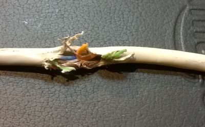

I think I found the problem...
I don't think it as chewed, it was inside a non cavity wall, I think what has happened is that the initial damage was possibly done because it was between a hotwater pipe and sharp brickwork so over time it's rubbed, then when I pulled it it got worse.
This is if it's the actual original break and not one that I've done whilst pulling that section of cable free, I've still got to pull out the last few feet where it passes through the ceiling but that one was at about the right distance.

I rather cheekily reused the good parts of the old cable to make a couple of patch cables for the switch to the wall point (they're not going to get touched so single core should be fine) and they work, so it looks like it was that one break.
I was going to suggest that, as useless as it may be, that it would give some confirmation that the photo'd damage was the entire issue.
