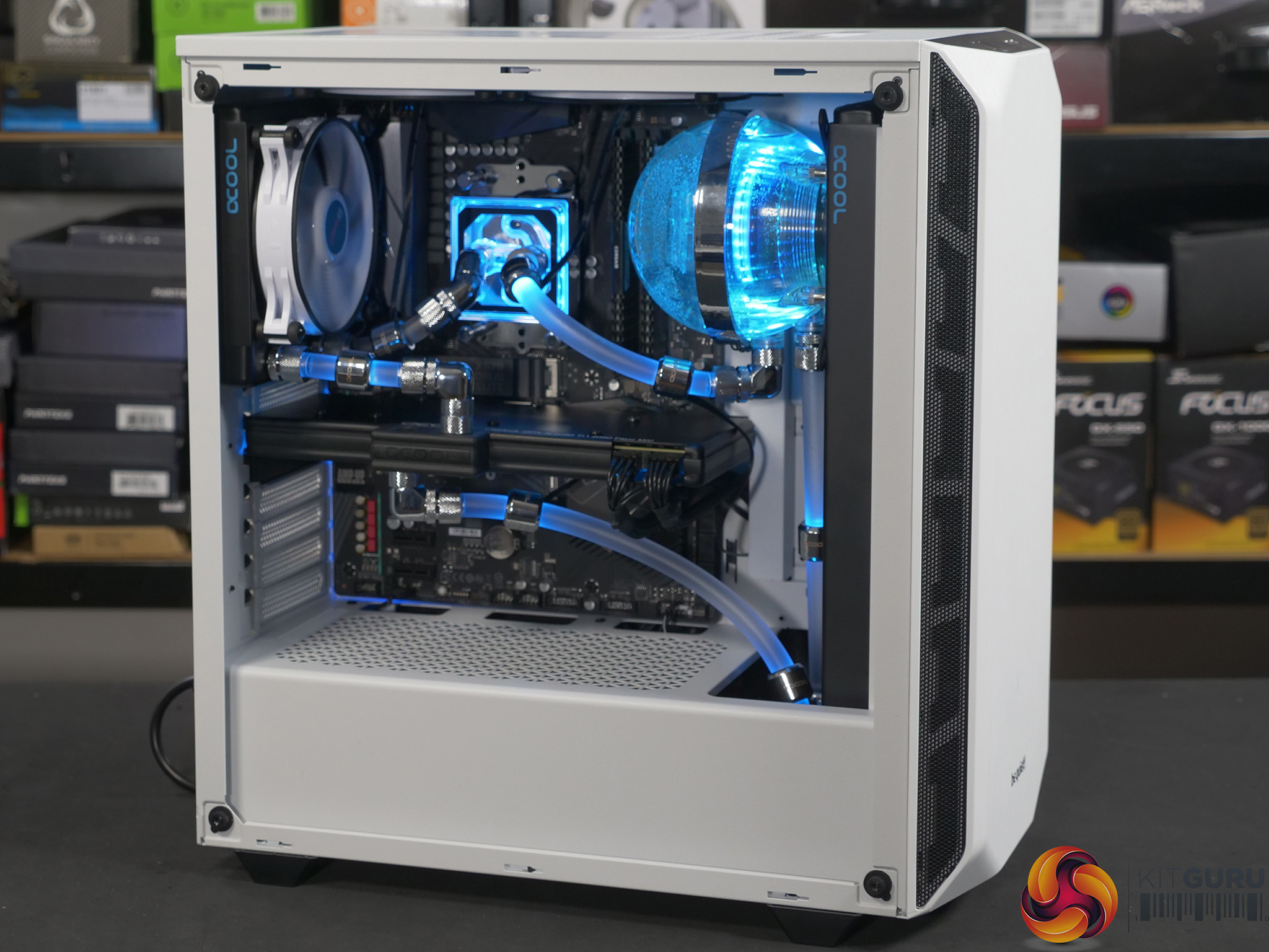

So been looking at the cost for the mobo, case and PSU and I think it's doable. The Pure base 500 looks like a decent case for the price, a little tighter than some of the bigger cases obviously but I think 240 + 360 should be doable.
Leo did a custom loop in the pure base 500, admittedly without a 240 rad up top. I think for the res/pump it would either have to attach to the front rad or potentially go for a horizontal mount below the GPU.
