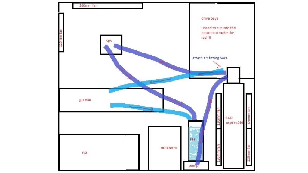

so this is what i intend to do in my corsair 600t
im certainly no CAD expert,in fact first time ive ever used paint on windows!
so try and bear with it
and this is where i want to go in the future
so is this posible? the reason i ask is cos of all the threads ive read(a lot) ive not seen anyone do it this way.
the res i was thinking of using,its got multiple options for inlet, can i have 2 going in? http://www.overclockers.co.uk/showproduct.php?prodid=WC-089-EK&groupid=962&catid=2133&subcat=2135
and will the pump be enough to do this?http://www.overclockers.co.uk/showproduct.php?prodid=WC-005-SW&groupid=962&catid=2141
the reason i wanted to do it this way was so both CPU and GPU will get cooled liquid rather than going through each other. so are the parts man enough for the job? or am i just off my head for even thinking it?:)
ill be using the koolance cpu 380 waterblock,with 1/2"ID 3/4OD tubing and various xspc fittings,if it makes any difference,not sure about the gtx block yet.
this is my first go at custom,ive read a lot but dont have the experience maybe one of you pros out there could advise?have a h100 at mo and its not man enough for my 3930k,so no overclocking for me:( oh some advice on 4 120mm high static pressure fans(quiet as poss) would be appreciated too thanks
I think you'd be better off with the tried and tested formula of a Phobya 200mm rad in the front and a slim 240 up top if you want to cool both cpu and gpu.
thanks for ur reply,i looked at the 200mm rad but it means cutting away just a little bit too much of the bays unless i put it upside down! also couldnt find any decent static pressure 200mm fans.is the rad ive chosen not that good then?if its a case of it wont do the job for both then ill just do the CPU,surely it will do a really good job of that?
Also, I don't think the idea of using a Y-piece to split between CPU and GPU would work as one (I'm guessing GPU) wouldn't get much flow as the water would just go down the path of least resistance. I think parallel only works for things like GPUs where both branches offer the same restrictiveness.
thats a good point i hadnt really considered!mind you i did think the pump would be overkill and only so much fluid can pass through the CPU block,the rest to the GPU.
It's just that a 240 rad for both cpu/gpu is asking a lot, especially with a hot 3930K.
It'd be fine with just the cpu, but stick a 240 up top if you want to add the gpu to the loop.
ok so i think ive got my answer then.i know the 3930k is a hot one ,will i see much improvement on my CPU temps then if i use the pieces mentioned? so disappointed with the h100 performance that it scares me to fork out £350-400 for little improvement.right now i idle at 37-39 degrees on complete auto everything in the bios,if i even enable XMP mode it shoots up 5-6degrees then when i run intel burn test im at 66degrees in 15mins or less so cant overclock a bean! will that set up at least allow me a half decent OC?
I would go for the extra rad now m8 then if ya need to make any adjustments to your case to get it to work it means ya dont have to empty everything out l8r. When it comes to connecting a gpu at a later date it will then just be a simple matter of taking the pipe from ya cpu into your GPU block then run another pipe from ya gpu back into your res.
good point,thx
