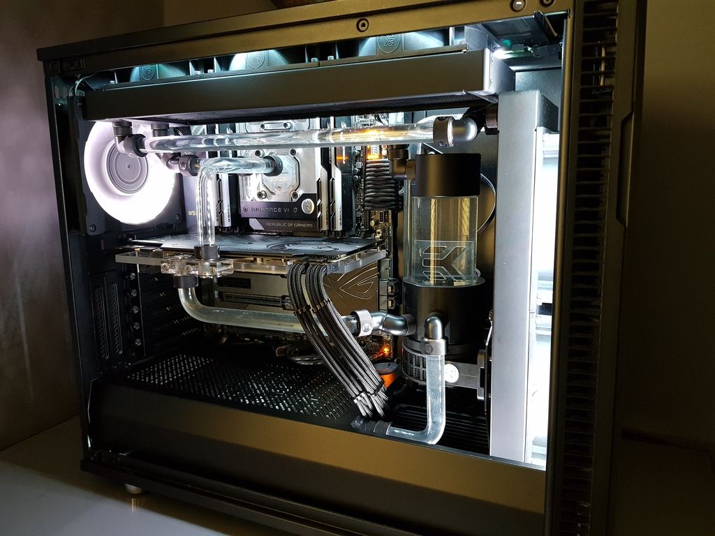

I want to know if temps are ok as only ever used AIO's.
This is the setup
7900x with monoblock @4.2GHz
msi 1080 seahawk
1x EK SE360 1x EK SE280 1x SE140
XSPC D5 on pump speed 2
all vardar ER fans running at 1000rpm
in a Fractal R6
on max load gpu and cpu getting 46c and 74c seems high? idles at 24c and 27c.
Using prime95 and getting gpu temps off msi afterburner and cpu temps off the oled on the mobo
Maybe need to reseat the block see if i put enough paste when I go hardline.

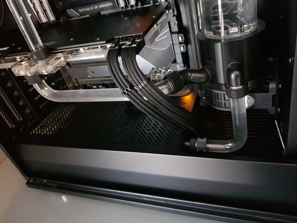

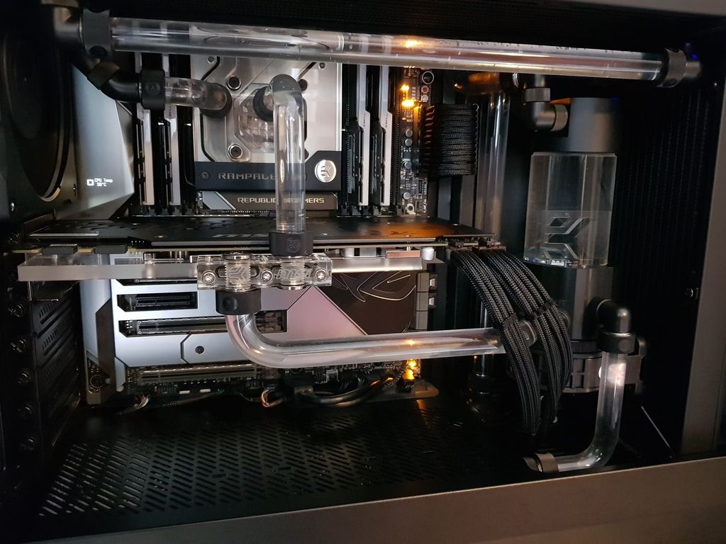

Gone hard line now think there is a bit of dead space under the gpu tho?
Coolent temp at full load gpu and cpu is about 39c.
I can imagine that could be an issue... Is that a Phanteks halo at the rear? Was thinking of adding some to my build
Some bends were just to hard to attempt for my first try so made do with fittings and yes thats the Phanteks digital halo along with 4 strips of their new digital RGB leds. The whole WC loop was a lot even without the GPU block set me back £900+.
I want to move over to glass tubes so tried to keep to only one bend in each run at max so I can get 6x glass with 90 bends and one straight run of glass to swap over but need to do something with the run from the gpu to pump.
