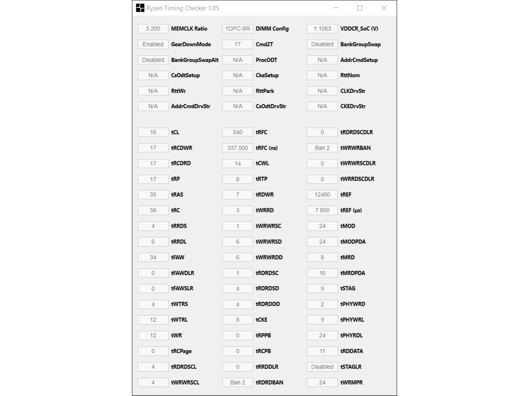

Hey everyone just got done with my first full memory OC feels like Ive spent days on it! well including reading up and trial and error i probably have.

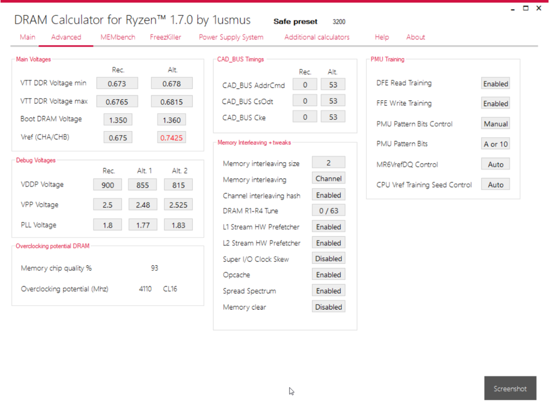

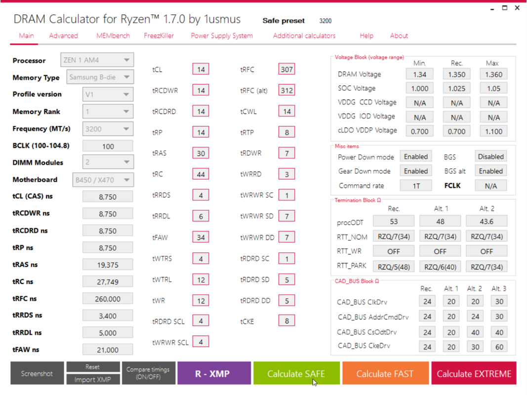

I used the Dram calculator for guidance but was unable to get near what i suggest but i did manage to tighten up the XMP profile default a little bit with a tiny increase of SOC 1.1 >1.1063 and Dram Volt 1.350> 1.360. with a lot of failing to boot and resetting cmos along the way.
I ran memtest for 2 passes without any errors and plan on running it for the full 4 when i go to sleep.
The only thin i will say is i noticed while booting up before Asrock appears on my screen i got a little flicker of green screen for about a second not sure if this is pointing to something bad about my OC ?
What was recommended by Dram Calculator
What i managed to get with 2 passes no errors.. will update on 4 tomorrow.

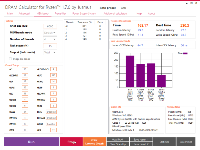

And Bench score

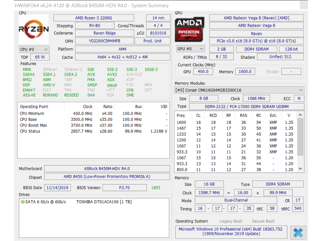

My Hardware
