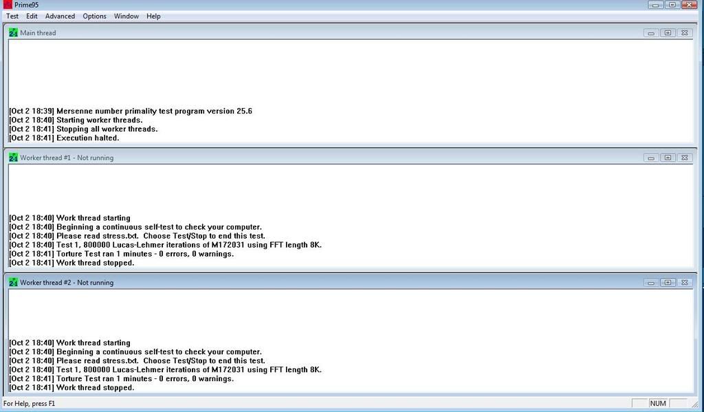

Ok guys just overlcoked the CPU to 3.48ghz and run the prime 95 Torture test for 1 minute and the cpu reached 80C :(
what can i do?
this is after 1 minute of reaching 80C

Yeah, definitely check that the cooler is seated properly and reapply the paste. You'll probably want an aftermarket cooler anyway because they're quieter as well as being more efficient.
Cable management is important for more than aesthetics because cables all over the shop can really wreck airflow. Unplug everything, grab some cable ties and organise it all as best you can :)

get some ocz freeze or as mx-2 or something and a TRUE and youll see MUCH better temps.
just upping the fsb is fine, until you reaqcj a limit then you will have to look at other options.
