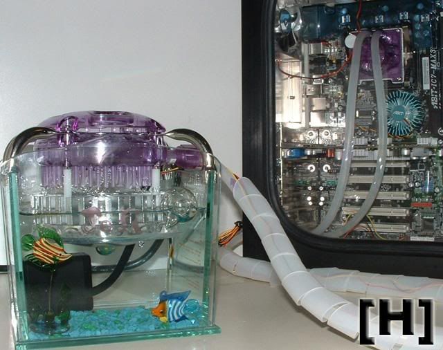

nothing to stop you immersing a rad in the tank as part of a closed loop so the 2 lots of water don't mix, only issues would be if the fish don't like warm water and if thats not enough to run it passive because obviously you couldn't have fans.
I think the fish get grumpy at being boiled - there is, however, a mod somewhere on the internet with this being done. I'm just too tired to hunt for it :)
